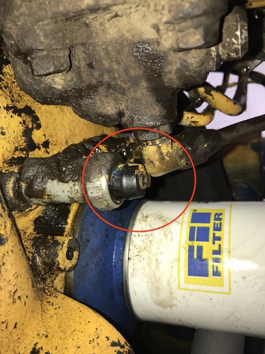

I need to drop the pan and take a looksee at the oil pump. My oil pressure readings are a little low and I suspect the pump screen is clogged or the pump is worn out or the relief valve is funky. Either way I need to get the pan off. I read in the book to take the small bolts out (like a car or truck oil pan) then simply carefully drop it. However, this doesn't look to be the case on my tractor. I circled the bigger nuts and bolts. I assume those have to come off or out. The front are nuts and the bolts seems to be part of the inner pan? How did I get this pan off?
Also it looks like the wire is missing from my oil sending unit. The warning light wire. Doesn't anyone know what color white goes on there from the loom?
thanks

The wire is white/brown tracer. Them 2 nuts along with 4 bolts on top along with steering rod and radius rods. Drain rad pull hoses. If has front mounted hyd pump itll have to come along with dropping one end or the other of loader and moving forward about 4 inches. Missed some other misc items but that give you a start.

The color of wire will be the same as the wire going to the warning light...lol
my 3500 diesel had a white wire with either a red or brown stripe.....kinda hard to tell in my pic

My warning light is not hooked up. It is basically a rats nest in there. Some of it I have wrangled some of it I have not

You basically have to do a front split.
If you have a way to support it, ie a hoist
or rafters, you can pull the whole bolster
and axle forward about 3" and leave the nose
and radiator attached. There are two big
bolts that attach the pan to the
transmission that must come out, then the
pan bolts.
Pan weighs about 80 lbs so use a floor jack
to lower it.
On reassembly, don't use the cork type pan
gasket. Use the thin paper type.

The two front bolts are studs and can be screwed out of the pan, the two back bolts will pull out to the rear.
You can loosen the four bolts that hold the bolster to the block enough to allow a little separation for easier pan removal in installation.
As said prier that pans weighs around 80 lbs so use a floor jack to remove and install.
