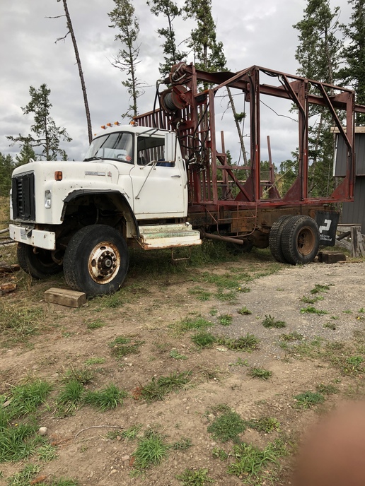

Im tinkering on a 1977 international loadstar 1700 4x4 for a friend of mine. It has a perplexing braking issue. I repaired four wheel cylinders on one side of the truck and bled all the air out of the system. However after a few minutes after bleeding or truck sits overnight when I push the pedal it goes right to the floor and then it stops at the same position every time halfway up if I press pedal say 5 or 10 times. Normally if there was air in the system the pedal would come up a bit more on each sequentials push and its not. Any ideas?
The V-8 is on propane. Just recently after it warms up it starts belting out white smoke. The smoke only last for a few minutes then goes away. It doesnt necessarily smell like coolant either. Then after 5 to 10 minutes its starts doing it again and then goes away. It has been running rough on idle and I only pulled the spark plugs out on the driver side and number 7 had a rusty plug. 1, and 3 were tanned. 5 was very clean. Compression even on all drivers side cylinders. I had a brain fart and only checked the plugs on the driver side thinking it was dual exhaust like my 3/4 ton truck. However its single exhaust with a Y pipe.
The owner has invested quite a bit of time and some money into getting this truck ready to go back on the road and hes thinking about just selling it as is or parting it out. The cab and chassis are in excellent condition and it would be a shame to see it not be put back to use. It has a homemade system for winching on logs and then dropping the logs at a log yard or in your yard for firewood say.
Any suggestions to start trouble shooting brake pedal issue and engine intermittent white smoke would be greatly appreciated. Thank you.

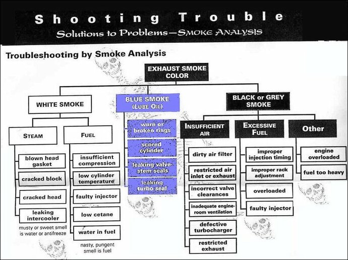

Hope this helps with the smoke issue

PostPosted: Fri Apr 16, 2021 10:44 am    Post subject: Re: Brake problem and engine white smoke issues Reply to specific post Reply with quote
Less blurry
