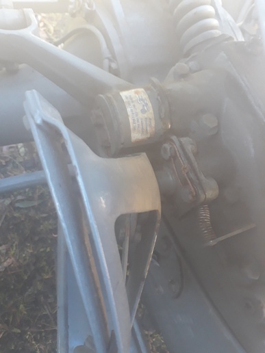

With no wintering in Arizona this winter.......I Just received Bearings, gaskets etc., for the TEA-20 FERGUSON "OVER /UNDER Sherman Transmission".
Also the three point lift control for the Ferguson.......
Shall see how this plays out in the spring...

Just curious as to where you got your parts from? Is that a position control I see in the wrapping?
Good morning Bruce(OR)........
Parts were suppled by RED ROCK MANUFACTURING ...located in IOWA..
Yes, that is a position control device..
Located info on Internet......
Service was 100%.....Smile
Pic of Position control device "is pic taken off internet"..
Bob..

Do you have the Sherman that is made for the Ferguson? I have an over/under Sherman for a Ford but I believe that it will interfere with the start linkage if I install it in my TO-30. Has anyone done a work around for this?

Here is a thread about a TO-30 rebuild and Sherman install - https://forums.yesterdaystractors.com/viewtopic.php?t=1343049 part way thru it is a post about the Ford vs Ferguson differences and workarounds.
Here's a thread (two actually) about the starter linkage issues and resolutions. https://forums.yesterdaystractors.com/viewtopic.php?t=1344326
https://forums.yesterdaystractors.com/viewtopic.php?t=1348379
Yes I HAVE / OWN the SHERMAN "OVER-UNDER" made specifically for a Ferguson...
In the spring of 2019, I ran an add for a Sherman OVER UNDER,specified it must be for a Ferguson....
Plan is to install SHERMAN in TEA-20 Ferguson Spring / Summer 2021....
Bob..
As per picture:

I have this modified top cover and case to fit a ferguson.
