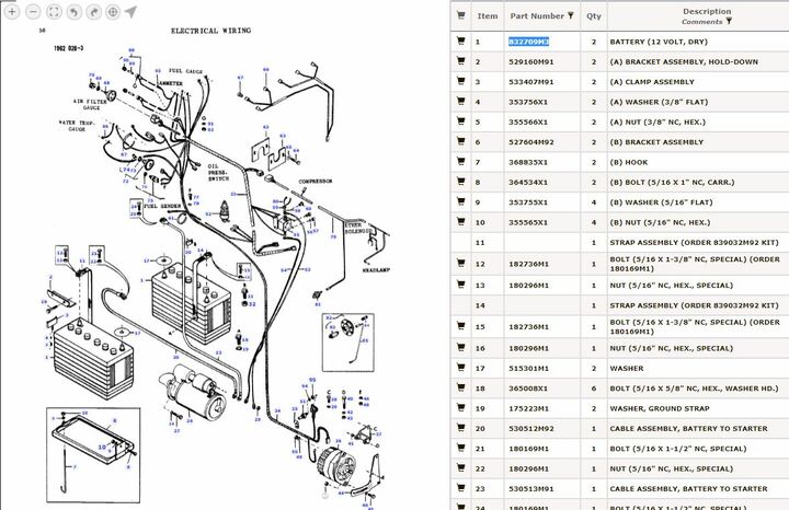

I am sending this message to look for a great recommendation of energy efficient battery for my Massey Ferguson 1105 . I contacted a family business company that sells parts also for Massey Ferguson tractor, they seem to suggest that there should be two batteries, at opposite end, but I didnt see any other terminal to hook a battery at the other end, in fact the battery we use to start it when we are buying it was removed from a car and I dont think that is great fit for it, that was my reason to look for a good one that is recommended for the tractor, thanks

The dealer you talked to is correct, the 1105 parts book shows it was originally equipped with two batteries. I haven't been able to cross the Massey part number to a common group/size. Someone on the MF Forum may know the size and rating of the original batteries. Lacking that, what physical size will fit in the battery box, the highest CCA (cold cranking amps) rating you can get in that size, and your normal ambient temperature range, you should be able to pick a battery. What is your general location? Starting power requirements are different in southern Florida and northern Maine,, for example, due to the differences in temperatures at times during the year.

As Jim said, it calls for 2 batteries. There is one on each side of the tractor under the platform and behind the steps that swing out. I use 2 group 30 or 31 in our 1135. If your weather doesn't get too cold you could get by with just 1.

Measure your battery box (es) first. Commonly used batteries
have changed a bit since your tractor was made. There are
some battery specification resources available by googling
battery group sizes. Pay attention to not only LxWxH
dimensions, but also post location. We’ve converted
everything we could (based on size) to Group 31 batteries. I
believe our White 2-105 would be similar in battery
requirements. Replaced original 2 battery system with a single
GP31. Started well in all weather. Make certain all cables are
in good shape, clean and tight (at all ends)

I use 2- 29H batteries 950 cc amps in those tractors and are a correct fit and all. I think they are 12 years old now.
