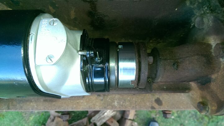

First fitment of Bosch FU4 magneto to Farmall F12 Good to have a local engineering shop. The new coupler is exactly 20.5mm thick and the slots on one side are narrower than the original to fit the smaller lugs on the Bosch magneto. The tractor will need various other works done before it runs, but this is a good start

Is that coupling from the IH mag, and if so, does it time the same with the Bosch mag, just thicker?

I had the new coupling made same as the one for the IHC magneto except much thicker and narrow slots on the magneto side. From the parts book it looks like the Bosch magneto used the IH coupler, but had a thicker piece between the coupler and the magneto drive shaft. All being well it will time up correctly - something to test on the weekend!

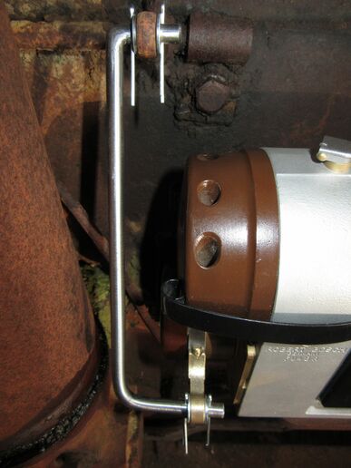

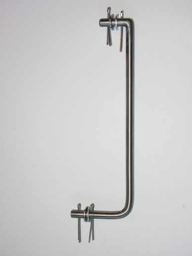

Had the spark control rod made for the Bosch FU-4 magneto. Local engineering shop made this too.
I'm no draughtsman, but the engineer managed to work it all out.
Test fit tomorrow

In place and spark control rod works

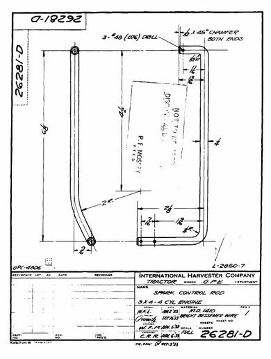

I need to make a spark control rod, as you have done. I was able to get the original engineering drawing for it from Guy Fay. Let me know if you want it, even though it looks like you have it made already.

The mystery part 12251 D (magneto coupling block) does the same job for the Bosch magneto as 12740 D does for the IHC E4-A and F4 magnetos. That is the disc with the timing holes in it, you can see on the right side of the picture - between the new coupling and the timing case. I just kept the magneto coupling block from the old magneto. The new spacer had to be machined on one side with narrow slots as the driven plate on the FU-4 magneto has narrower lugs than the IHC magneto.
Yes please, I would be very pleased to get a copy of the original spark control rod drawing - I made mine up by putting the magneto in place and taking measurements as best I could. I also have a couple of Bosch FU-4 books - parts list and an IHC manual for the FU-4A magnetos - 99% identical to the FU-4B.

Attached are the engineering drawings.
