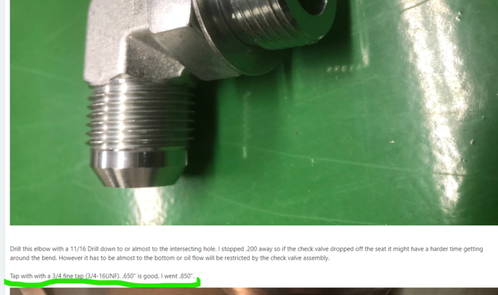

When drilling the fitting am I supposed to drill to a depth of
.650 ?

I would think you would have to drill deeper then .650” because he has the hole tapped to the depth of .650".

He probably drilled it about a 1.00” if he stopped at .200 and tapped it .805”. Going by his numbers he has typed up.

The valve measures about an inch and 410 thousandths so I don’t know what the numbers are he has . I don’t have a drill press or a bit

The valve measures .769 diameter so that doesn’t fit .850 either . I’m not doing the work anyway

I drill them all the way to the intersecting hole as the original service bulletin states. Tap deep enough for the valve seat to thread in to the shoulder.

Where do you find anything that matches up with .650 or .
850?

That's the depth to which you run the tap down into the fitting.
I suspect you can get by with the lesser depth if using a bottoming tap to finish vs. using a "plug tap".

That makes sense . Now I just need to get it off and take it up
and let them do it . The dealer is sending a copy of the service
bulletin then I can take that with the parts
