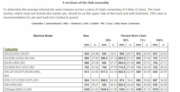

For private use tracks will usually run a long time beyond where the industry standards used to determine life have been exceeded from what I have seen. The wear on the sprockets and pins in your pictures indicates to me it is beyond 100% worn if properly measured, by the book specs. If you replace sprockets you need to repair/replace the track chains as the sprocket teeth won't match the pitch of the worn links and wear on both will be accelerated. And the rollers and idlers should be done at the same time for best life. As far as how the sprocket gets replaced you need to research that. It might be a weld on ring or it maybe a complete sprocket, I don't see it bolted on as segments would be. If your equipment inspector was familiar with crawlers he should have been able to measure the undercarriage for you and tell you where it is at wear wise.
Here is an article explains undercarriages and how to measure them. It is a Dresser document, but is common to all crawlers. Cut and paste this in your web browser (remove the * from between tractor and parts before searching). http://tractor*parts.com/pdfs/undrcarguide.pdf
Remember you are looking at a $5000 Cat 951. There is a reason it is priced at that amount.
As for your pictures, you just need to reduce their size. I use Paint to change the pixels from over 4000 (yours) to 1000 pixels on the largest dimension of these.
And here is a chart of wear to life of chains from on line. It may or may not be correct for that machine, I won't say, but it give you an idea of what it may be.
