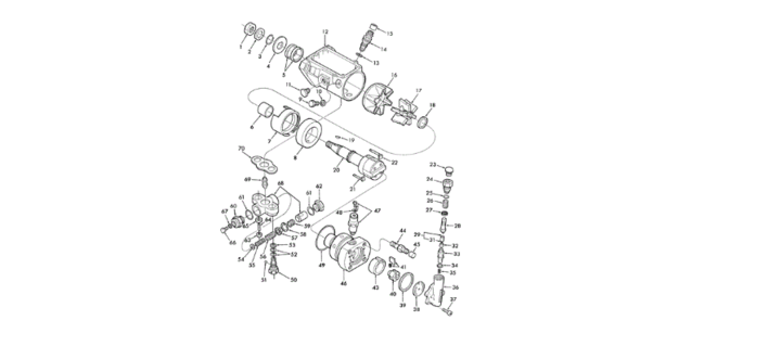

does anyone have any idea what it would cost to have a dps injector pump off a ford 6610 gone thru and resealed?
it has a pretty constant trip while just sitting and i have to turn the fuel valve off or it will leak a good bit of fuel just sitting.
im need to take my loader off so i can get a better look but it looks to me like it is leaking where the round body slides into the main housing, and i think number 49 oring in the drawing below is probly the problem.
is this a job i should try and tackle myself? i have pretty good mechanic skills but the injector pump is the one part of tractors i have never been in.
i can find videos and writeups of rebuilding the dpa model but not the dps.

The DPS pumps are much more complicated than the DPA models are. Repair cost depends on if cam ring/scroll plates are worn. or needs the hydraulic head. I've seen them
repaired/tested run about 450, but they can also be much higher depending on internal parts wear. The DP200/210 models are even MORE complicated..

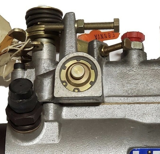

Mine started leaking recently, having read about a o-ring leak issue others had I cleaned the pump and with the engine running fuel was leaking out around the cover that is held in by a snap ring.
They say it's a simple fix but I haven't got around to mine yet.
Clean your pump and see if fuel leaks from that gold colored plug, mine is.

mine was also for sure leaking there. i replaced it couple months ago wasnt nothing hard about that. but it still seeps alittle.

took loader off and cleaned it up and it looks like the majority of the fuel is coming from around the throttle shaft coming out of the top.
