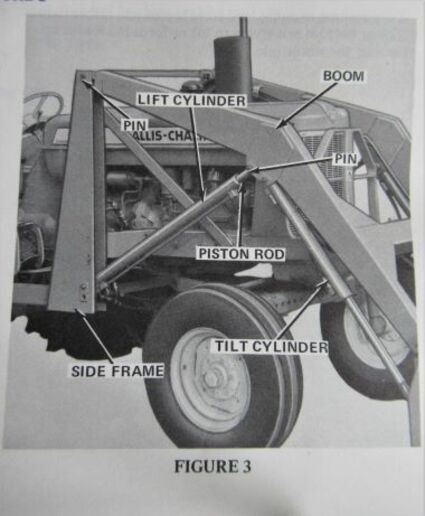

I used my D17 to lift a disk I bought and it pick up the earth with it (6" frost). It also lefted up an entire John Deere 24T baler with kicker that had no wheels so I could back my trailer under it. The only issue I have is the support brackets on loader are giving out. I'm thinking I will need to make a bracket to go over the hood and then run some uprights to it from engine tractor frame bolts or?

Reinforce them and see what bends next. Unless there is obvious deterioration of the supports it could be a sign of overloading. Just because it can lift something doesn't mean it should. JMHO

I wonder what model loader you have. Both the A-C model 400 and 500 loaders are set up like you propose to do. Looks easy to duplicate.

Allis Chalmers 170 made by freeman

Over the top is fine, but there should also be one down near the bottom of the towers if there isn't one there already.

I had a Miller Quick -Attach Loader on a D-17 that had a frame around the tractor front that it rested on and was the ground foot when dismounted . It had 2 way lift cylinders and lifting a complete combine grain head onto a truck at full extension both cylinder rods bent. They were too small diameter for the piston .
