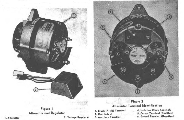

It has a new one wire alternator that is a Delco remi and its an all purpose, I just wanted to know if I had to wire it differently with that alternator, it had a factory alternator. The voltage reagator when hooked up to battery or constant power off alternator doesnt really seem to regulate the voltage since I hooked up a test light to it and it still lights up no matter what wire I hook it up to on the regulator

OK, so I was not that far out. A 1-wire alternator has an integrated regulator and does not need the old regulator. Better run a new wire from alternator to the battery post on the starter, and leave the old wiring as it is, for now.
To be certain about what you have, can you post a picture of the back of the alternator and/or a link to a seller website that shows it?

PostPosted: Wed Apr 14, 2021 6:08 pm    Post subject: Re: Ford 7100 instrument panel Reply to specific post Reply with quote
Here it is
[img]https://forums.yesterdaystractors.com/photos/mvphoto73615.jpg[/img]

PostPosted: Thu Apr 15, 2021 5:40 am    Post subject: Re: Ford 7100 instrument panel Reply to specific post Reply with quote
It looks like a Delco-Remy 12SI type alternator. It has an integral regulator, so you do not need the old regulator.
Under the rubber cap is normally an "R" post used for tachometer, not interesting in your case. At "1" and "2" there might be lugs, even on a 1-wire alternator. On a three-wire alternator the are used for sensing and warning light, but I do not know what their purpose are on a 1-wire.
Maybe you should contact the seller and ask for a wiring diagram?
I suppose you have a Ford 7000, 4-cylinders (a turbo charged 5000), not 6-cylinders?
Did the old setup look like the one in the attached picture (Motorola)?
If yes on both, I have a wiring diagram for it.

PostPosted: Thu Apr 15, 2021 7:08 am    Post subject: Re: Ford 7100 instrument panel Reply to specific post Reply with quote
I think it was a Motorola but has been replaced with the one wire alternator, I do have the 7000 with 4 cylinders with a turbo, and have had a wiring diagram and it didnt work. Any other ideas?

PostPosted: Thu Apr 15, 2021 8:00 am    Post subject: Re: Ford 7100 instrument panel Reply to specific post Reply with quote
Loganthefordy wrote:
(quoted from post at 19:35:20 04/12/21) ...
I am not certain what the problem is. You run the charging wire to the post on the starter solenoid, to which the battery cable from battery (+) is attached. The old regulator is of no interest when it comes to charging with the new alternator, since it has a regulator inside.
With this configuration, and engine running, you measure the battery voltage between the battery posts, and the voltage should be around 14 V, not less than 13.8 V. You may have to rev the engine up to, say, 1800 rpm in order to get the charging started.
