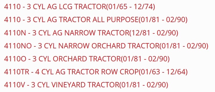

So what I have is a 1965 4110 with 3000 brakes. What would I order for hydraulic parts under the seat 3000 or 4000 parts.

PostPosted: Tue Apr 20, 2021 5:41 am    Post subject: Re: Ford 4000 or is it a 3000 Reply to specific post Reply with quote
You order parts for 4110. Make sure you choose the LCG (01/65 - 12/74), not to be confused with the other 4110:s.

You say it is from 1965 but I can not find anything in the thread how you determined that?
The model code starts with "D", and that points to an assembly date later than March 31, 1968. Furthermore, 4110 only had the Select-O-Speed transmission in the early years, at least for basic models. Look at the attached picture, which is a screenshot from an ad brochure that this forum's rules forbids me to link to.
Maybe the 6x4 manual reversing was an option on the later models, but it is not listed among the transmissions on a CNH dealers parts list for 4110 (I dare not to link to one, the forum may explode)?
