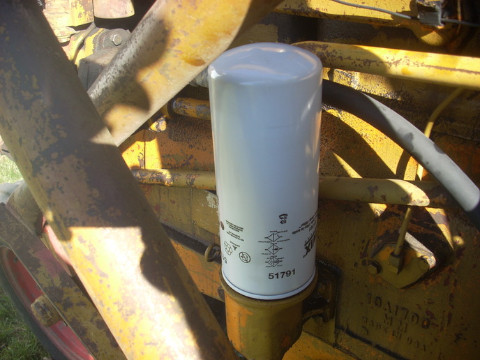

Don't know if Charlie Biler is still around, but I got my adapter from him a couple years ago. This is one of my UB's. I also have one on my UTS.

Rich, those oil filter photos mean a great deal to me! Thank you!
For me and my OLDER tractor, I could modify a canister/housing hold-down nut, silicone it to the top of the filter, paint it semi-gloss black and pretend.
Very interesting.
