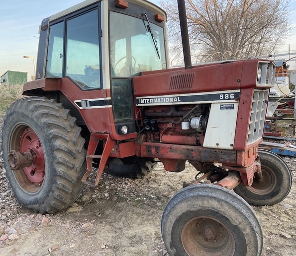

I bought a 986, yeaaaahh! I had been looking, going to sales, decided I preferred a 886 or 986 over a 966 or 766. It's in average condition, better than some I'd seen that had set out, and the nicer ones were more expensive. Has 10,000 hours, T/A works, $8,000, everything seems to work, AM/FM 8-track, ha!
Now I have to go get it this weekend. I've rented an F-350 and 20,000lb capacity gooseneck trailer, like this one. Trailer has 14,000 lb load capacity, Tractordata says the 986 is 13,000 working weight.
The questions I would like to ask:
Should I back it on?
Should I drive the tractor forward onto the trailer, or should I back it on?
Also: Where should I put the back wheels on the trailer? The trailer is much longer than the tractor. If I drive on forward, I would probably put the front wheels at the front of the trailer.
If I back on, then I'm not sure how close to the front of the trailer I should park it, how much of the weight should be on the pickup.
In this picture, I'm guessing the big tires are about 10 ft from the front of the trailer.
Thank you!

Drive it on forwards until the rear of the truck goes down about 4 to 6 inches.Lock
the brakes, put it in gear or park position, chain it on all 4 corners.If it has a
turbocharger, securely block the top of the exhaust pipe to prevent the turbo from
spinning. Drive carefully and good luck with it.

I would drive it on forward and put the rear wheels between or slightly ahead of the trailer axles.

On a gooseneck I pull on . With a bumper pull I back on

Your objective in front to back placement is to have an adequate but not excessive share of the load on the truck in order to have proper braking and to keep the "tail from wagging the dog" and causing a loss of control. Your easiest way to do this is as Centash posted: pull it on until you get a good amount of settling of the back of the truck. I think that 3-5 inches would be best.

If I'm just hauling one tractor they always go on the trailer forward...I want the rear axle of the tractor I'm hauling centered between the tandem duals on the trailer,some
times maybe just a few inches more forward....The Ford 6000 puller pictured weighs 5000 lbs but I also load my 10,500 lb IH 1466 puller the same way....Its worked
good...Backing them on puts too much weight on the truck..
