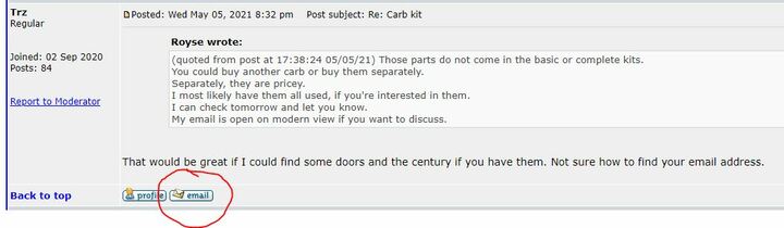

The button I circled should be on the bottom of my posts too.
If not, it appears I can email you.
