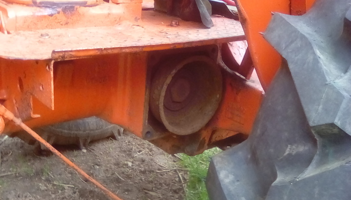

PostPosted: Mon May 10, 2021 7:25 pm    Post subject: Re: case 1955 VA Reply to specific post Reply with quote
Thanks Lee
Just need the springs for both rear drums and the brake shoes for both wheels.
The shoe i took off is really just a big metal ring with two linings
Adjacent to each other (opposite side to one another).
The internal levers, one side for working the other doesnt work at all and been soaking it in PB blaster since sunday..moves about 1/8 of an inch..all rusty inside that one
I would like to resurface the drums but not sure if there is enough material o them..both are real rusty..looking for the top to.get that big but off...
Pn

Finally got thru with looking at the brakes..need alot of parts
> two drums - VTA-2805 x 2
> two brake bands (one for each side) VTA-3090 & VTA-3091
(might be able to use linings only -VTA-2819)
> all the inner springs (3 per side) - VT-5092 x 4, VT-5093 x 2
> Two oil seals behind the brake drums. ???????
(oil leaking bad)
> two springs on the outside of the brake (brake Returns)
cover holding tension on the foot levers - VT-2155 x 2
That is a big list if I want brakes..all the internals are oiled up/broken/rusty..
Looking for a tool to take off the drums nut VT-5095
Do you think any of these parts are still available ?
thanxs
<pn

Pnettis
New User
Joined: 06 May 2021
Posts: 18
Report to Moderator
PostPosted: Mon May 17, 2021 6:30 pm    Post subject: Re: case 1955 VA Reply to specific post Reply with quote
Also, might be able to turn/mill the brake drums but until I get them off I would not know for sure..they look like the originals.
Most likely will not clean up
Lastly still need to get the tork tube seal inside by the bell housing
and clutch assembly.
<pn
