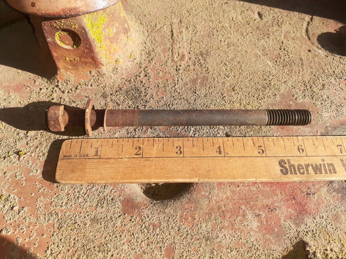

This bolt was found on the ground a few feet from my Farmall H.
I looked for an empty hole, but could not find where it came from.
It's 6.25" long, 7/16 14 thread, one standard washer and a smaller thin washer.
Please let me know where this bolt came from. Thank you!

maybe the belt pulley attachment.

Has it got the dot in the middle of the head, That was a IHC trademark back in the day! Later they used WP, for West Pullman

One of the two long belt pulley gear box mounting bolts. If gear box is still on look toward top.

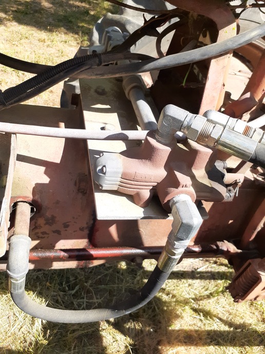

I think rustred has it. To me it does not look like that tractor has been driven for a while. Are parts of it torn apart or were
they at some point? That bolt absolutely cannot pop out of its hole. In fact with the gas tank on I think you have to pull all
the bolts loose on the belt pulley and pull it out of place with the bolt still in the hole, same for reinstall. Maybe this only
applies to an M.

Not the long belt pulley gear box mounting bolt.

well show us the belt pully drive not the hydraulic's

He cannot show you the belt pulley because it does not have one. OP why do you think that bolt is from your tractor? Did someone take the belt pulley off while it was setting near that area and install that plate with the hydraulics on it. Now you are just finding the bolt that was set aside some time ago? Tell us the WHOLE story.

Another possibility is the engine to clutch housing attachment bolts. Do not remember how long those are. I think the longest ones are the upper ones that the steering shaft bearing support and gauge mount plate are also attached with.

I even looked at mine and yes that is the bolt. So it must have just been
left there as used red said.

Yes, you solved the mystery of the ghost bolt! I removed the belt pully a long time ago and recently moved it to my bone pile. It was moved crossing in front of the H a month ago. I used my H a few days ago and found the ghost bolt a few feet in front of the H.
Thanks, now I can tell my doctor I'm not crazy yet!

It looks like the oil filter cover bolt it it has holes drilled through it.
