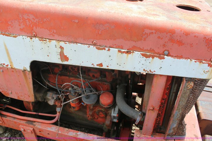

Do the Ford 134, 172 and 192 engines with hex oil pump drive use the same drive rod? I found a rod for 134/172 engines but I have a 192 engine in my Jubilee that came out of a Jacobson G10.

Should be the same rod EAF 66648-D. I don't have one a part right now and I loaned out my industrial engine book to a friend who is doing a 192 rebuild. I have a 192 in my NAA and if you have the
old oil gauge don't be surprised if it's pegged when you start it up. oil pressure is about 80 lbs in the industrial. If you still have the G10 a guy is looking for some parts. Send me you contact
info.

I pulled one out of 172D ag engine, it is .250 hex and 3.925 long. If you are in DFW isnt Lightbourne still over there.

Just came up on two articles that states that the pump rod is the same for the 172 and 192 engines. Both 1/4" hex. Can be made from a Ford 300 six cylinder shaft cut down. I have found a new one for sale and ordered it. I read it is recommended to replace it if rebuilding the engine or replacing the pump or distributor. I thank you all for the help and comments.
