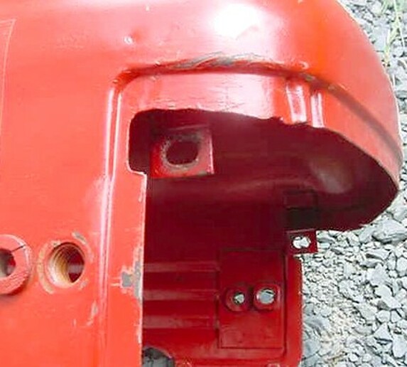

Interesting discussion down below. I learned something. All my cubs are missing the bracket that holds the hood to the radiator! Have owned a dozen cubs,not a one had that bracket. Any idea why?? '48-'74.... 9 were '49s

They break off. That's why you can buy replacements and weld them back in.
Borrowed image from "competing website:"

Oh and by the way the "square hood" ('63-up) tractors are held on differently. There is a bolt straight through the hood and a spacer.

Guess I will have to go take a good look at my cub and see if there broken off. They look simple enough to be able to make them

My hood has one of two of those but it doesn't line up so I can bolt it on due the the exhaust pipe not letting the hood go forward enough to line up. But either way I would prefer to have the doglegs and grill.

I just looked and my Cub has one of the two brackets but it doesn't line up to the bolt hole it should be bolted to due the the exhaust pipe not letting the hood move forward enough to line it up. I may try to heat the exhaust pipe up with the torch so I can bend it forward a little bit. The exhaust pipe on my Cub has been welded to the manifold and is a piece of water pipe

Well my hood had one on the right side but it didn't line up as it should do to the exhaust keeping the hood from going forward enough. The left side was broken off and there is a hole where it should be so I took a piece of flat metal and bent it to fit drilled out the hole in the hood to 1/4 inch and it now has one on both sides. Just came in from the shop from installing the hood for the second time. Used the torch to heat the exhaust and bend it so the hood would fit.
But I still need the doglegs and grill
