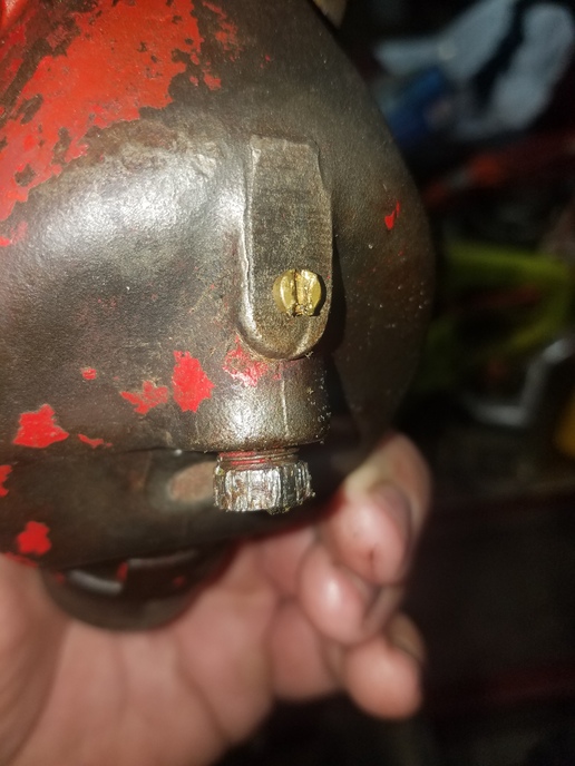

So I bought a '49 8N that barely ran, PO said it needed carb work and was running on choke. Did a compression check and had nothing on #3. Thanks to the wise and helpful people on this forum it turned out to be a stuck lifter. After days if soaking finally freed it up, doesn't want to start at all now. Figured the next step was rebuilding the leaking carb, and after further investigation he was not only running the wrong plugs but had 2 of the spark plug wires crossed. Fixed everything, still won't start. There is a tiny hole in the bottom of the carb eith what looks like a jet, gas is leaking out like a sieve! Can anyone tell me what's going on with that? Temporarily plugged it so carb would fill with gas but still nothing, not even a fart. So now I have good compression on all 4 cylinders, have spark, should be firing in right order now and still nothing? I'm still suspecting the carb at the moment, cranked and cranked to the point she should have been flooded, pulled a couple of plugs and neither smelled like gas (I've got old Harleus, been through this ritual before). Any ideas??

Check that #1 is on compression when #1 plug fires- your distributor could be 180 degrees off.
Sounds like you have a missing bowl drain!

From that pic it looks like the jet under the power valve?

That's not a jet, that's a drain... your float is stuck open
I don't believe a 49 distributor CAN be 180 out... it indexes into the end of the cam w I'm pretty sure, an offset slot

Not sure what you're calling a 'power valve'
When I replied I figured you were talking about the "sintered strainer lower body drain" in the pic

It looks like jet at the bottom of the carb, can't believe if there's more than a quarter inch of gas in the bowl it drains.

The blue line in your pic, except it's angled the other way. Threaded hole with something that looks like a jet in there, except no way to get it out, no slot or anything on top?

Still don't know what you mean.... is the part you're talking about labeled in the pic?

No not labeled in the pic, tiny hole at an angle opposite the drain plug

Ok I think you mean this...

Could be, will pull it and post pics tomorrow

Making some progress as you started with a tractor that would run only with the choke was pulled out.
Also found out it had a dead cylinder with no compression due to a stuck lifter.
Got that fixed and found out it had the wrong plugs and two spark plug wires crossed up.
Now you have a stuck open float needle and seat to work on. Most likely fouled plugs to go with it.
Strange how you went from an engine that would only run while choked, to one that has a stuck open needle and seat. This tractor is going to keep you busy.

Plugs are not fouled, seems like gas is not getting to them at all, don't think needle is stuck open, ir moves freely when carb is off. Yeah def keeping me busy, and frustrated as well.
