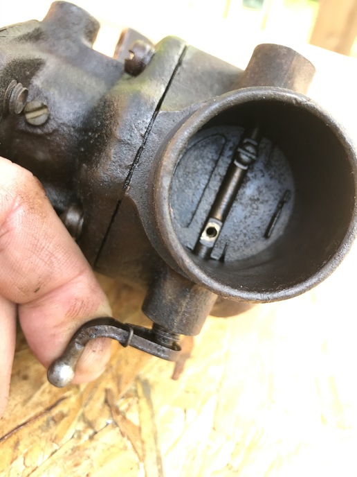

So after looking as some pics of carbs it's pretty obvious I lost that small brass plug in your pic. After digging through some old threads it was mentioned that this plug is actually an adjustment and not just a drain? Can anyone verify? And where in the heck am I going to get another one??

I'll have to verify when I get home, but I've been thinking about this all day. I think I MAY have sorted out another piece of the puzzle. The carb had definitely been messed with before, it had a viton needle. I think whoever did it may have put the choke spring on backwards, and me not thinking about it put it back the same way. I think the spring was holding the choke closed, that has to be bass-ackwards! Like I said I will verify later, but this could be the reason it would only run with the choke "on"! Can someone tell me what that "trap door" does, and if it's supposed to be facing in towards the carb or out? Right now it is facing in.

Choke is correct, thought I had an epiphany but it was just a braih fart 🙄

The 'blue line' reference and the brass screw pictured near the bowl drain is only plugging a drill passage used in manufacturing the carb and there is no reason to ever remove it. You are seeing the main jet via that hole. It is accessed by removing the nozzle at other end of that blue line.

hogluvr wrote:
(quoted from post at 19:51:37 05/14/21)
I'll have to verify when I get home, but I've been thinking about this all day. I think I MAY have sorted out another piece of the puzzle. The carb had definitely been messed with before, it had a viton needle. I think whoever did it may have put the choke spring on backwards, and me not thinking about it put it back the same way. I think the spring was holding the choke closed, that has to be bass-backwards! Like I said I will verify later, but this could be the reason it would only run with the choke "on"! Can someone tell me what that "trap door" does, and if it's supposed to be facing in towards the carb or out? Right now it is facing in.
No harm intended you probably all ready know all of this but FHIW
First off if the "trap door" as you put it is facing into the carb, it's " bass-backwards ". It should be facing out to release the pressure if the engine back fires while starting with the choke closed.
Second : IMHO, from the amount of information given, you have a TSX 241-B carb, the attached link may help you verify that ; https://www.carburetion.com/CarbNumber.asp?Number=TSX-142
Third : Carbs, have 2 fuel supply circuits.
One, is low idle, idle screw proportions the gas mixture under slow engine idle, low air flow condition. The choke functions with this circuit by further restricting the air intake to increase the gas portion of the mixture by limiting air intake for starting.
Second, is the power circuit side of the carb which adds additional fuel as engine speed increases. It has 2 main components, the main nozzle and power adjusting needle. If the main nozzle is not clean it will not allow the correct air/fuel mixture to allow the engine to accelerate.
IMHO, from your description, the main nozzle needs to be removed and cleaned. The attached video shows the carb cleaning process, hopefully it will help in getting your tractor to run. https://www.youtube.com/watch?v=rZ7qJobmuHk

Jo Bird wrote:
(quoted from post at 10:53:33 05/15/21)
The correct choke position:

OK that is exactly how mine is set up so I guess I'm ok there.

hogluvr wrote:
(quoted from post at 18:07:43 05/15/21)
missing a screw

Yeah I know I took that picture as I was taking it apart so I would put it back together correctly 😁
