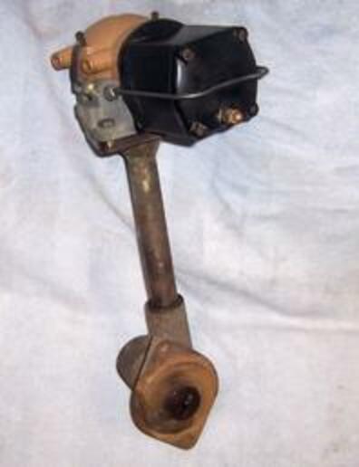

PostPosted: Fri May 14, 2021 3:49 pm    Post subject: Re: Ford 8N? Angle Drive Distributor Reply to specific post Reply with quote
JMOR wrote:
(quoted from post at 19:34:10 05/14/21)
R Geiger wrote:
(quoted from post at 19:31:33 05/14/21)
zmanvortex wrote:
(quoted from post at 16:23:31 05/14/21) I am working on my neighbors Ford tractor and from what I can tell it is an 8N. The serial number stamped on the block above the starter is hand stamped 315981. It is not prefixed with anything. I discovered that the distributor rotor was not spinning when the engine turns over. I removed the distributor assembly from the block and started looking for parts online. It appears that I have a rare distributor setup that I cannot find online. I remove the assembly from the front of the block using two bolts and removed an oil line that connected to the distributor shaft housing. I discovered that this is a 90 degree angle drive that connects to the distributor shaft. I discovered that the angle drive gears had broken. I am unable to find this type of angle drive anywhere online. The angle drive shaft has a slot on the end that meshes with the slot on the end of the camshaft where it bolts to the block. The bolt pattern and recess look exactly like the front mount distributors that I have seen online with the slot. Can I just mount one of those front mount distributors in place of the angle drive and distributor? I would post pictures, but I am a new member and apparently I can't post pictures yet.
Thanks.
The angle distributor drives were used with magnetos, I have one on one of my 8ns that has an industrial motor in it. works good. you see the angle drives on ebay from time to time.
true, but not exclusively.
Case in point.
TOH

PostPosted: Fri May 14, 2021 4:03 pm    Post subject: Re: Ford 8N? Angle Drive Distributor Reply to specific post Reply with quote
yes, and I will go out on a limb and make a WAG that this is the one he has:

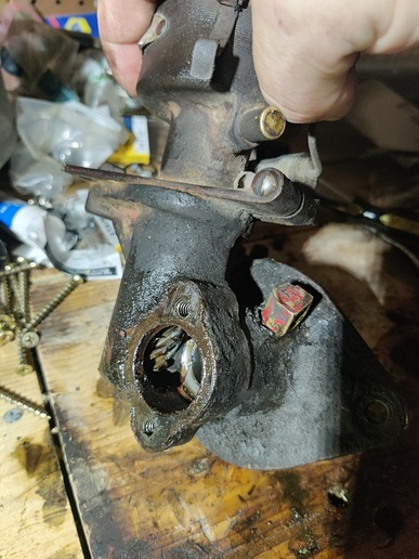

PostPosted: Fri May 14, 2021 4:53 pm    Post subject: Re: Ford 8N? Angle Drive Distributor Reply to specific post Reply with quote
Hopefully these pictures can upload.

PostPosted: Fri May 14, 2021 5:01 pm    Post subject: Re: Ford 8N? Angle Drive Distributor Reply to specific post Reply with quote
zmanvortex wrote:
(quoted from post at 20:53:32 05/14/21) Hopefully these pictures can upload.
Holy Over Engineering Batman!!!
I was expecting a simple mitre gear drive not a spiral bevel with pressure lube!!! That is going to be hard (not impossible) to fix and it wont be cheap.

PostPosted: Fri May 14, 2021 5:04 pm    Post subject: Re: Ford 8N? Angle Drive Distributor Reply to specific post Reply with quote
TOH
TOH, I would be fine with just installing a front mount distributor. Do you agree that would work fine? Is there a particular model I should buy for, or are most of the front mounts the same for 8N, 9N, 2N?
