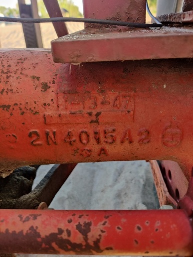

Louis A, help me out. What do you see in the pictures that suggest 2N? I am going to attach some pictures of cast markings from the axle that may suggest 2n.

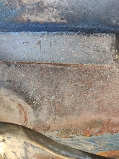

Cleaned up the hand stamped serial number on the block real good. Not prefixed by *N. Here is the pic.

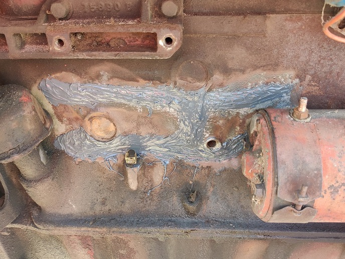

Don't know if I should be proud or embarrassed with this repair on the same tractor. Neighbor left straight water in the tractor through the winter and cracked the block. I cleaned it up and JB welded it. It is holding water just fine. I find it amusing that all of the cracks were right around the frost plugs which didn't do their job Smile
What makes me think that it's is 2N is:
3 speed transmission that was used on 9N and 2N
Steering box and dash is the style used on 9N and 2N
Running boards are either aftermarket or homemade that hang on the factory foot pegs that 9Ns and 2Ns used. 8Ns had factory running boards that mounted different.
Brake pedals are the style used on 9N and 2N (Right brake pedal on the right side of the tractor and left brake pedal on the left side of the tractor beside the clutch pedal) The 8N has both brake pedals on the right side of the tractor and just the clutch on the left side.
Oval radius rods that Ford started using on the 2N in 1944
The casting mark that you show on the axle trumpet has the casting date above it that reads 1-13-47 which would put it in the years of 2N production. I would say that the tractor is most likely a 1947 Ford 2N. I hope this info helps.

Absolutely helps! Thanks! It is in fact a 3 speed plus reverse.
