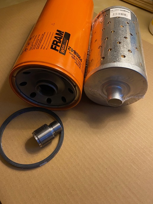

So here is what I am going to try for the '53UB. One is the spin-on type and uses an adapter. The other is supposed to be a direct replacement for the original canister-type filter. Have not tried either, but will soon and follow with observations.

The oil filter adapter is an odd sized part. The filter side for the UB is 1 1/8-16 thread. The other end is 11/16-16. Odd size. You probably will not find one apart from those that offer them specifically for the MM U-types on eBay, for example. They get plenty for them.

By gum! Been wishing to see the whole sh-bang. That darn replacement PH8842 filter does seem to be about the size of the old canister.
Haven't checked current pricing but figure around 30 bucks from Mr Biler.

I don't recall the price of my adapter from Charlie, as that info is out in the shop right now. I used a Wix filter, which is what he recommended. It is also a tall filter. Pictures of it are in this thread.

Just checked, the 11/16 threads in the oil filter housing on your UB's go back to the start of 21-32 (FT) and KT Twin City tractor production in early 1929 but that shouldn't be surprising as it's still a full-flow Purolater filter assy.
Sure, a few minor changes along the way but still the same concept and GB had said a couple years ago that the newer filters would bolt right on the older engines and he's right.
