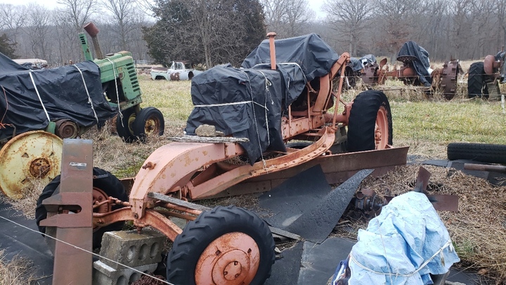

I just got this old tractor.
I passed up one of these 35 years ago and always regretted it.
Tell me what you know about it.
The numbers stamped on the differential are ( WC 74311)
Its unstyled but right on the border of the change.
Hand crank only. No starter.
Its not locked up. The only problem that I have found is that the steering shaft is just spinning going into the gearbox. I'm hoping its a pin or a key broke.

A couple more photos

I have a 1947 W Speed Patrol. As for your steering it could be a number of things. Follow the linkage for the steering to make sure there isn't a broken pin some place. I have the parts manual for the W Speed Patrol by the way. The manual shows to u joints so at either one of them there could be a broken pin. The engie should be the same as used in the WC tractors.

The shaft is turning all the way going into the gearbox so its in the gearbox.
Its free spinning with no noise. Ill have to pull the gearbox. Hoping it's simple

Yes parts manual show a break down of the steering gear. But it doesn't show any pin or keys that I noticed

I should be able to braze a piece of pipe in the top of the exhaust manifold where that piece is broke out but its good to know that replacements are available.
Overall its pretty much all there. Those helper springs are missing from the blade lift mechanism. I have a good photo too try to match those.
The rear tires are gone. The tread pattern looks like a original advertisement I seen. All the blade joints are tight.

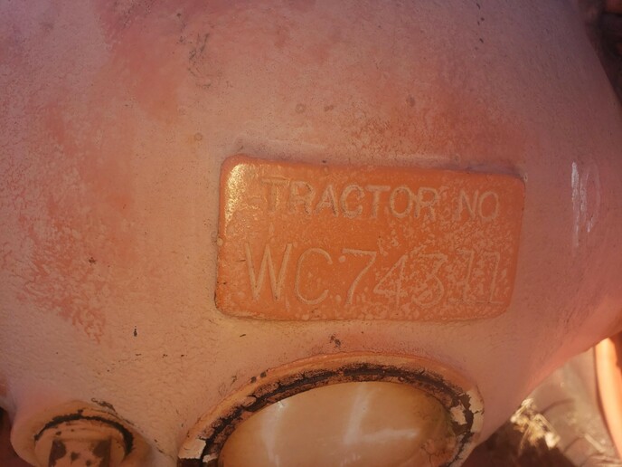

Here is a photo of the Tractor No. on the differential. It looks like late 1938. WC 74311

And the serial number
change. The early speed
patrol was before 1940. I
think.
Im a farmall guy so AC is
new to me.
Is my engine the 203C?
I.
Looking at photos and
reading but I need a
manual.
Can anyone direct me to the
right manual. WC74311 is
the tractor number on the
differential.
