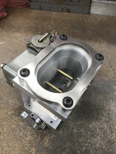

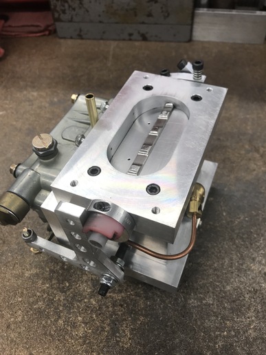

I've developed an oval venturi/oval throttle bore single barrel updraft carb for large displacement vintage pulling tractors. The oval shape allows for a compact high flowing single barrel carb. This prototype flows 450cfm at 1.5"Hg, and is slightly smaller than the Holley 2300 series two barrels. This carb is designed to work on engines in the 250-300hp range. There is room to scale that flow up or down, to suit specific engine combinations. This carb can also be made in a side draft version, with a slightly different fuel bowl configuration. If you are interested in a carb like this, for any engine in the 150-350hp range, please contact me. I also build billet round bore tractor carbs in the 250-350 cfm range.

how do we adapt that to a round manifold in tight spaces

There are some nice oval to round transition tubes that can be used to act as an adapter and part, if not most of the manifold's plenum. I have one that is for the air inlet end of this carb, and one of a slightly smaller size would do the trick to adapt it to the intake manifold.

The adapter tube would not need to be as long as this one, and probably couldn't be, being that vertical space , as well as space around the sides, is limited. That is why I kept the overall height of the carb to a minimum, without giving away its ability to meter fuel and flow air well.
What type and size engine are you working with?

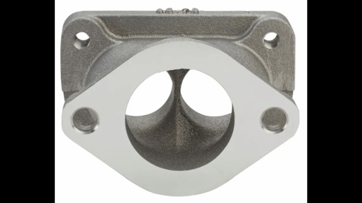

I believe that this adapter could also be made to work, with some modifications.

The cast aluminum adapter, even if it is thick enough to be modified to accept the oval bore carb, would definitely cause some significant flow loss. The flow loss could be enough to make it not worth using the big oval bore carb. The performance of your tractor engine would probably be better with a round bore carb that was designed to fit your intake manifold, in the confined space you have. I build those,too.
