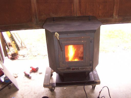

I bought another England pellet stove off CL 2 weeks ago very reasonable (bottom pic). This is the second one I've bought used this way. first one I got 2 years ago this month (top pic) and have pretty much heated the house all winter with it. This one is the same model only 1 year older, both had a burn't up auger motor in them which is an $80 repair. Both were completely disassembled, cleaned and inspected. all motors are common between the 2. I'm planning on putting the newest arrival in the utility room in place of the other one, and moving that one to the kitchen (other end of the house) and installing a couple convection draft registers in the ceiling to heat the upstairs. The top picture is the first one and the bottom is the "new" one, it has a new paint job since the picture was taken. Both pictures are during the 'test firings' down in the garage.

I'd like to find a Harmon PC-45. They have interchangeable fire pots and can burn pellets, grain and unoficially coal.

Keep checking CL. I've seen a couple PC-45s on there in the past but $$$. They are a good stove, Dad had one of the first one's and liked it.

What did that used pellet stove cost ya?

Paid $300 each. Noticed this morning they are $1,500 new at Lowe's.
