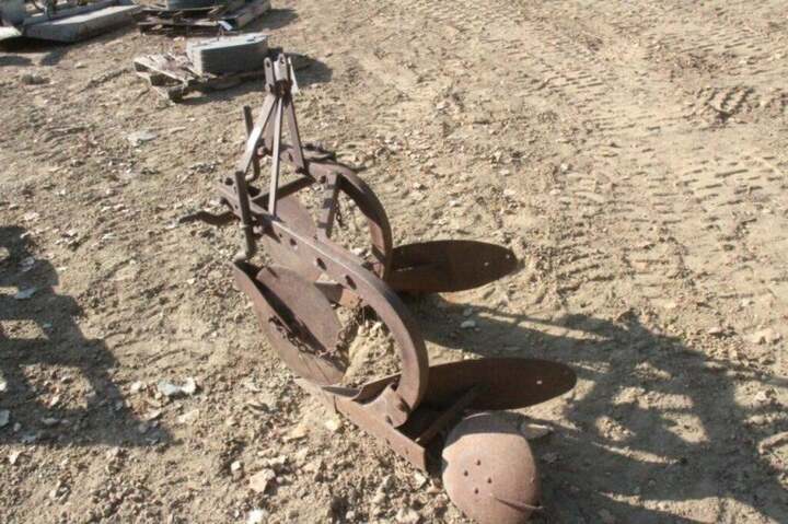

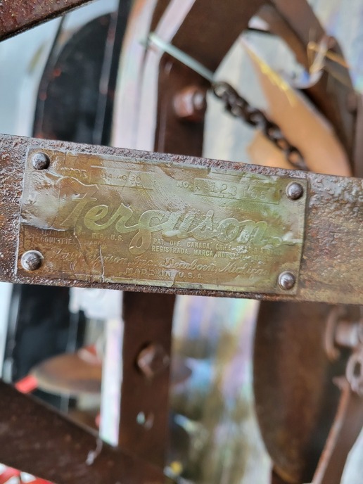

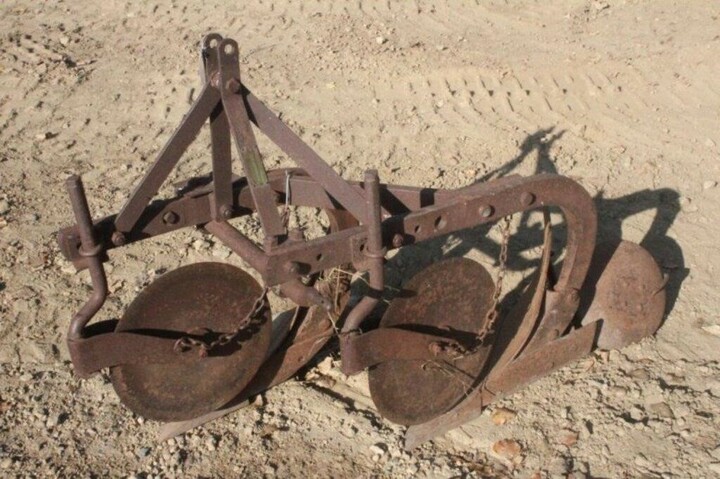

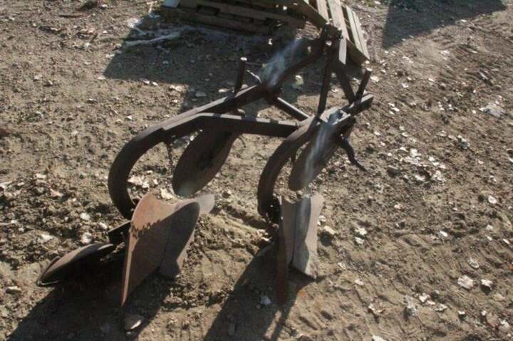

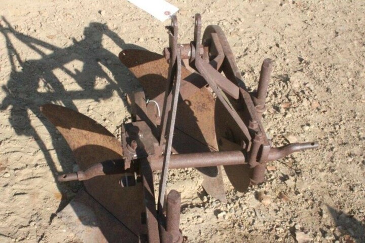

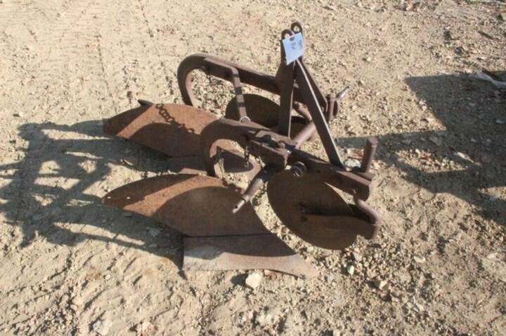

What can any tell me about this Ferguson 14-AO-30 plow what year was it made general condition, what's missing off it etc.?
Serial 123166
Made for the TO30 tractor and that would have been before Ferguson and Massey joined, But not before 1939. Cannot see edges of shares to tell condition there but rest looks to be better than average with nothing but tractor missing.
I agree nothing like hitching them up and scour them up . See what happens . Cant see the photo the suction or if the a large land on the shares . Land slide looks like they had it set up pretty good , till get a closer look
Try them , good going
