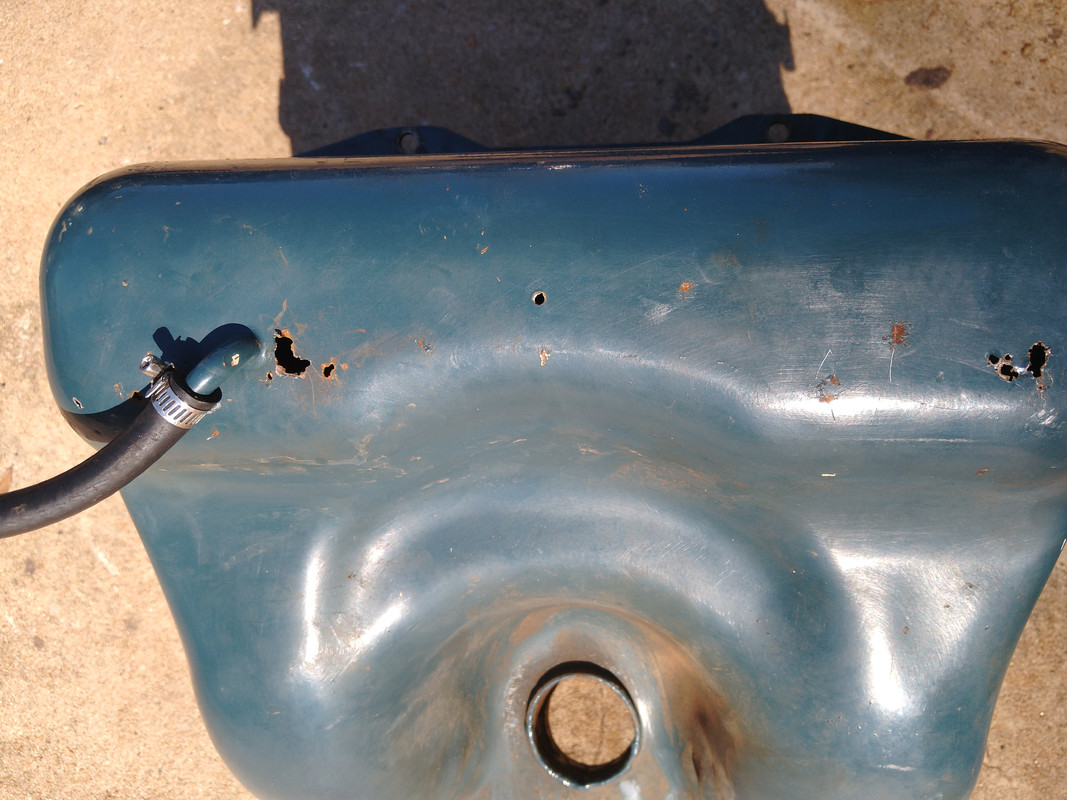

I've got rust holes in the bottom of a 40 year old Kubota tank. The holes shown in the picture are from after I cleaned the inside with E85, flushed it out, and dumped in a bunch of pea gravel to shake around in soap water to free up loose gunk on the inside, and then me probing with a pick and small screwdriver to expose any other weak metal. All hole that I've found are on the bottom.
Repair options I've seen mentioned are JB Weld Tank Repair, other epoxy repairs, & welding.
The JB Weld reviews have a number of people claiming it was only a temporary fix. Similar with other expoxies.
I have welding options (MIG & TIG); my skills are decent, but still amateur level. What I would like to do is cut a patch for each hole/area, bolt it in place, and then weld it all up, but I don't have an access hole large enough for my hand to work from the other side. I'd think if I tried to weld a patch from the outside, I'd end up burning through the thin metal.
The safest bet for me probably is to try the JB Tank repair, and if that fails, revisit this again. I'd sure like to get it right the 1st time though.
What would you do?
Only if a new tank is unavailable should that be repaired.
If I were repairing that, I would cut the entire section out, right around the radius of where the bottom
curves in. Chances ae that entire section is rusted very thin in other places too.
Then make a cardboard pattern, cut out a piece of sheet metal, and carefully form it to fit back in, weld
it up, leak test it with water. Keep welding until there are no leaks.
I've been running a couple of International trucks with JB welded holes in the gas tanks for years. Holes might have been smaller than yours. Seems to me I turned in a sheet metal screw and then plastered it and the area around it with jb weld. It worked for me.
I would have to question the claims of "temporary fix." IF you don't prep the surface correctly, the JB weld won't stick. Then as someone else mentioned, it's likely the metal around the holes is also thin and ready to give way at any moment, so is the repair leaking or is it just leaking in a new spot?

I would cut and braze patches in place. Much easier (for me
anyway) to get a leak free seam with braze. Or silver solder,
either is a good option.

Look up a product call Seal All it will be in a yellow/red tube. It is petroleum resistant. Sand the paint off around the holes until your down to bare metal. Put a bead of the Seal All
around each hole. Press screen wire down into the Seal All. Let that dry. They just add layer of the seal all over/into the screen until you have it thick as the tank was to start with.
Paint to the color you want the tank when done. I have Gas tanks on restored cars that have repair like this, that are over 40 years old and still holding well.

I wouldn't use any kind of epoxy. It will hold for a little while and then leak. I would cut small pieces of sheet metal and braze them over the larger holes. Then use a fuel tank liner
to seal the pin holes and prevent further rust.
Not sure i would go to 20 lbs of air. 4 to 5 lbs will find the leaks and wont launch it into orbit like 20 lbs will.

I am going to answer this from experience , like rusty6 suggested solder with a patch .
make sure the area is bare bright clean , prepare a metal patch that is bare bright clean , tin the tank
and metal patches and solder .
I have repaired diesel tanks and gas tanks in this fashion.

For my repair, I just used my MIG welder to fill the holes. Most of the smaller holes were easy without burning through, but some of the other larger ones I laid a bead around the hole and build up filler on the ID until the hole was gone. This was not 100% effective in that I can see some pinholes with the tank held up to the sunlight, but these are so small that I feel that filling them with SEAL ALL should be effective. Once I do that, I plan on putting a layer of JB Weld with the cloth reinforcement over the whole bottom area as mentioned on the 1st page by Jim in LA.
It's a bit convoluted, and I'm sure that it could have been done better in a single step by a number of you fine people, but it seemed the best option for me and my skills. I'd have cut the bottom off if it weren't for the fuel outlet tube on the bottom that I wasn't 100% sure of being able to reattach it well enough.
I figure that this should work, probably for quite a while, and if/when it fails, I'll cut the bottom off and weld or braze a new one on as suggested. This gave me more experience with the MIG welder and gas tanks that will come in handy when that time comes.
