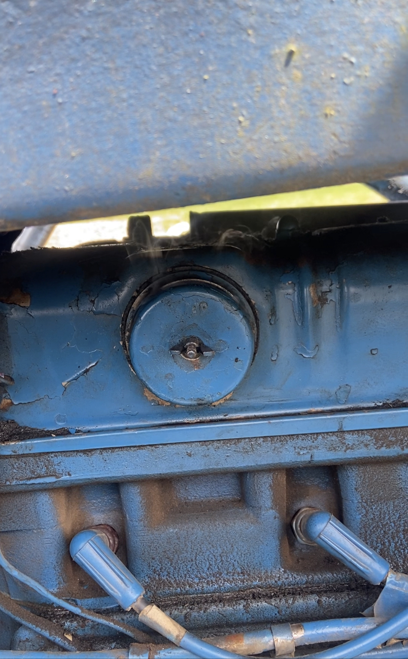

thanks for the response, that is very helpful. hard for me to tell what the difference would look like between smoke and cloud of vapor to be honest, tried attaching video but it wouldn't go through. (maybe this attached picture is helpful?) its gas and has antifreeze in it. ive been working her pretty hard the past week plowing and discing and it hasn't rained in at least a week so I don't know how water could all of a sudden get in there, pulled dipstick and oil looks clean too. will follow up with what I find after letting it sit for a bit and cracking the drain plug.

Smoke would tend to be more streaming like versus vapor or ventilation where it would tend to be wispy like for lack of a better way to explain the difference. Most engines will wisp some fumes of oil water condensation and such out of the vent tube when used. Our old 830 Case used to do that some new. Was never a problem in the 2500 hours or so we had it. Yes the checking for water/coolant in the oil would be a best start as it will wipe out the crank and bearings quickly.

To add to what others have said and maybe this is a repeat, if the amount of smoke or vapor is not like a “freight train” fog coming out of there it is probably normal. Your engine has some wear and blow-by. Blow-by being combustion gases that get past the rings and pistons and into the crankcase, this is the built in vent for that.

Looks and sounds like blowby to me from rings getting worn. Possibly valve guides getting worn.
I wouldn't call that amount excessive. Now if you get a cloud you can't see to drive or are choking on don't want to run the tractor because of it that's different just like Used red MN stated above. I don't remember dads 64 having a vent that didn't have a pipe to the ground i'll have to look. A bit of blowby is to be expected especially if you are working it hard that's normal. Your tolerance to the amount of it will be the determining factor in wether you want to put rings in and check valve seats while the heads off id do both when you decide to do it. Beyond that as long as it starts run her. Alot of engines have much worse blowby and have run for thousands of more hours.
