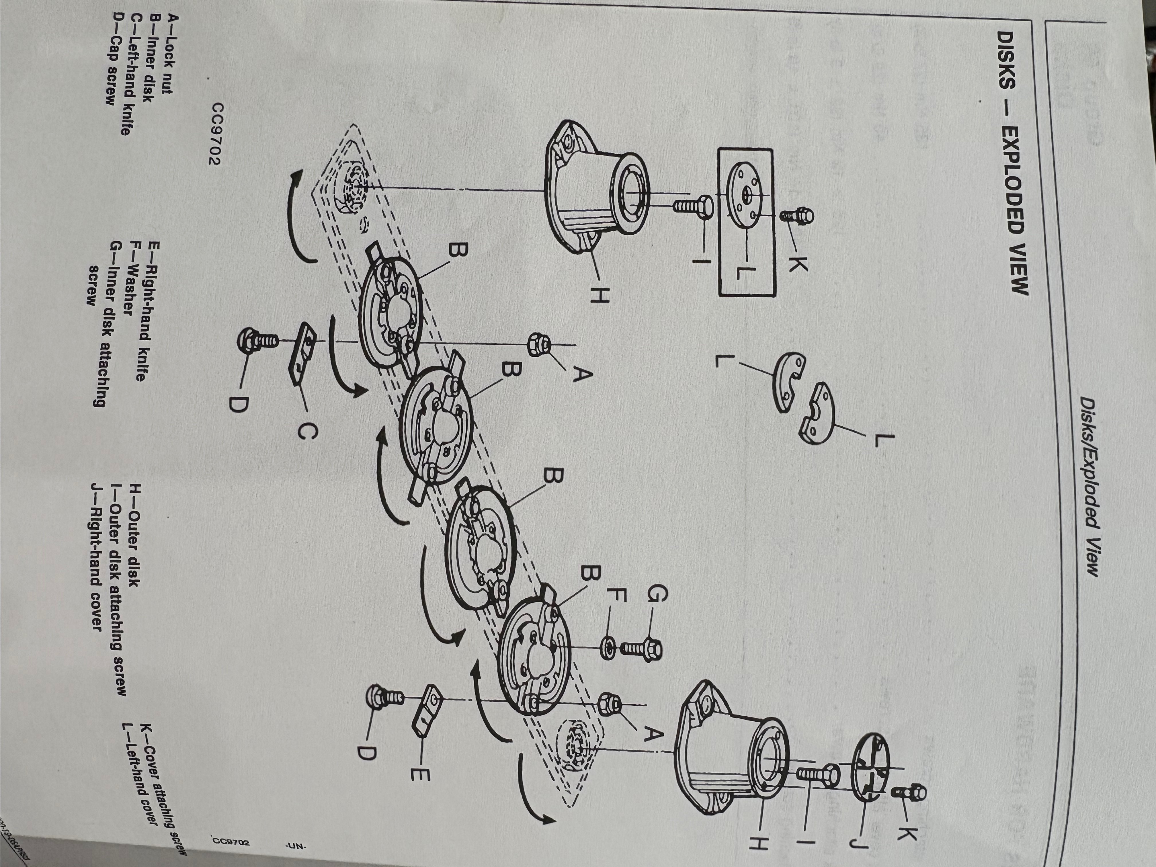

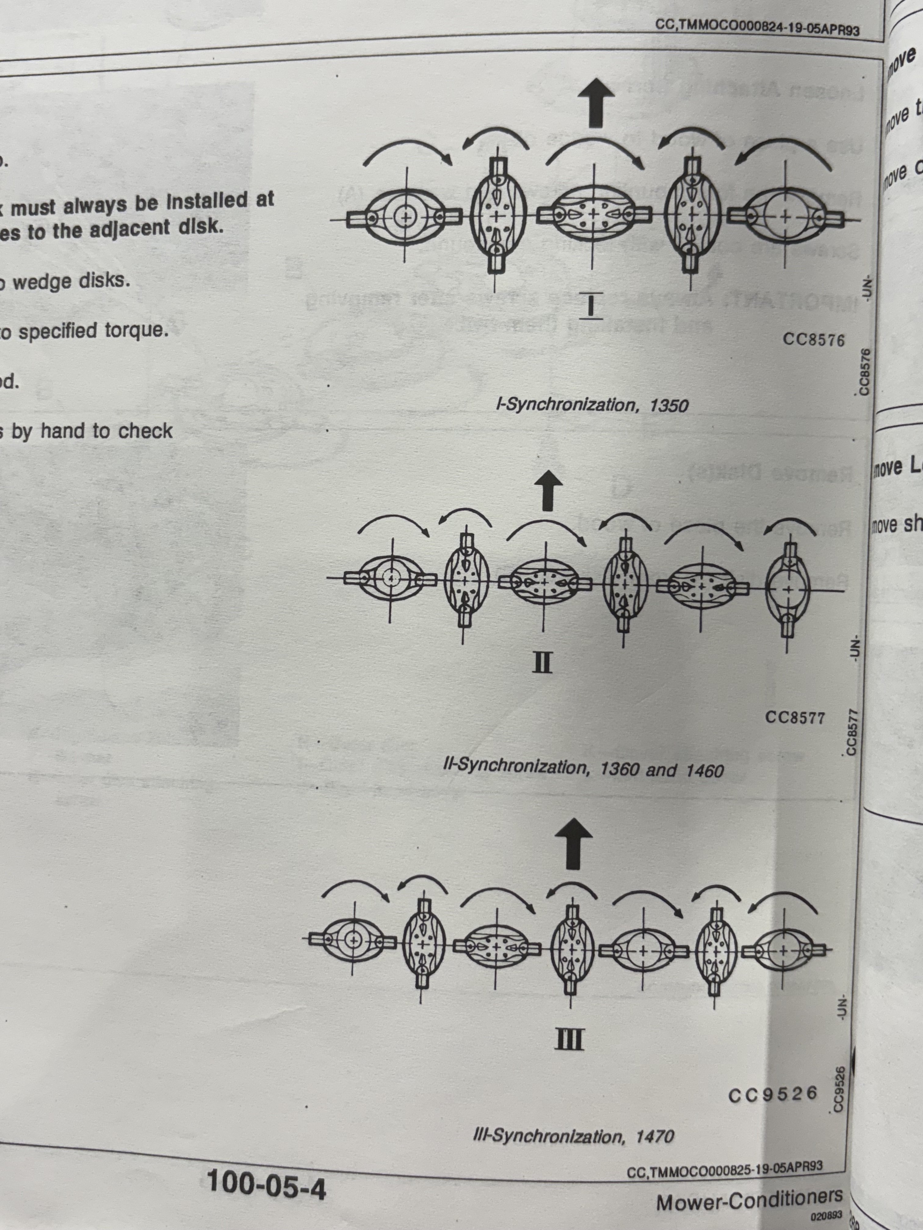

Anybody have any wisdom or secrets to share on how to time the turtles ? Bearing went out on the first one and it was just taken apart !
