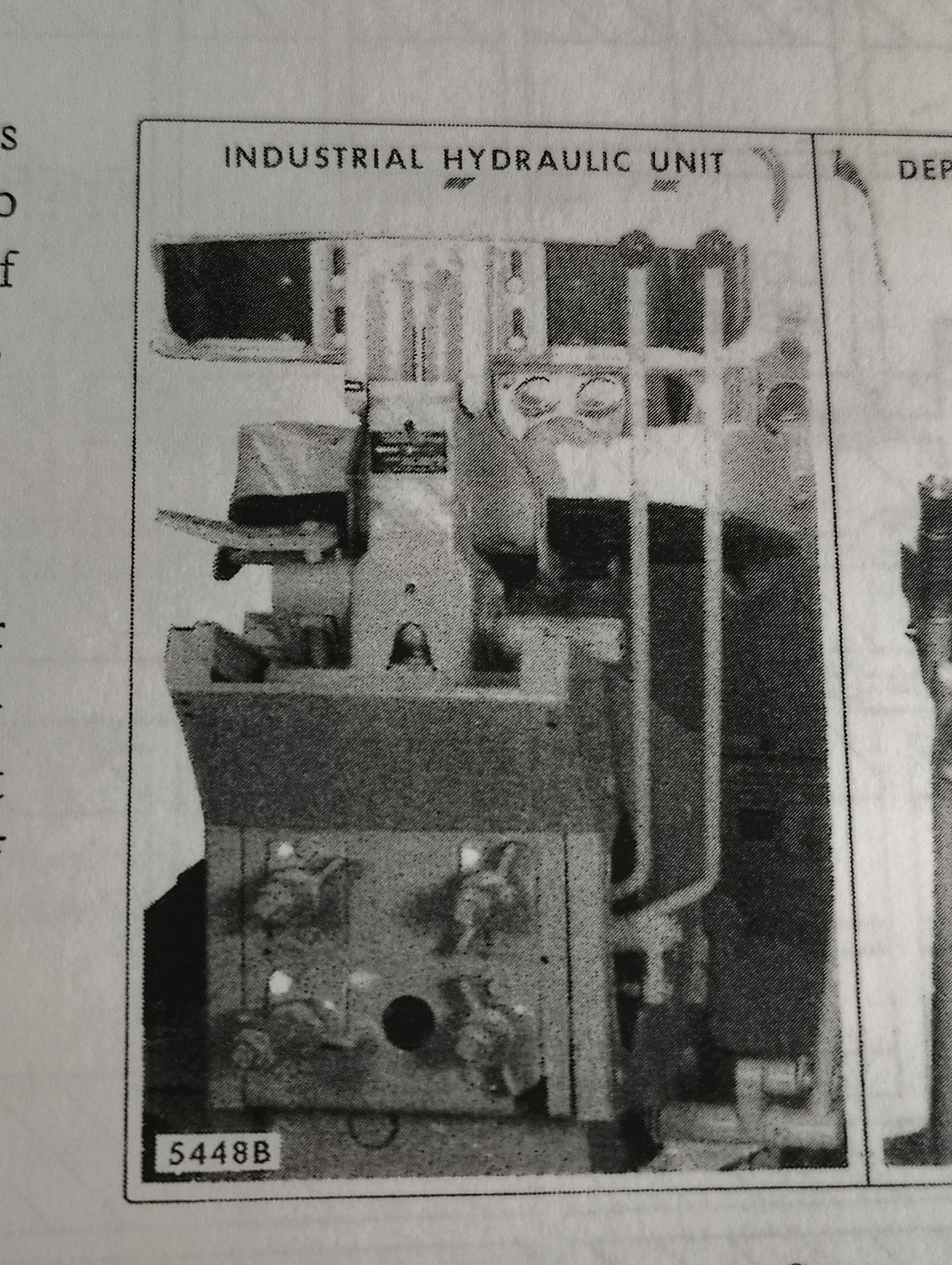

To use the remotes we need to rev the motor to at least 1200 rpm. Fluid levels are up. I think this means the pump is weak and needs rebuild.
What is involved in rebuilding the pump?
Normal, OP manual says rev to 1000 min for hydraulic and three point use. It has a flow divider to direct the first 5 GPM to the steering. That pump is obsolete. Check the pressure first. Mine was only putting out 500 psi when I got it. Tore the pump down and found the seals were blown.
