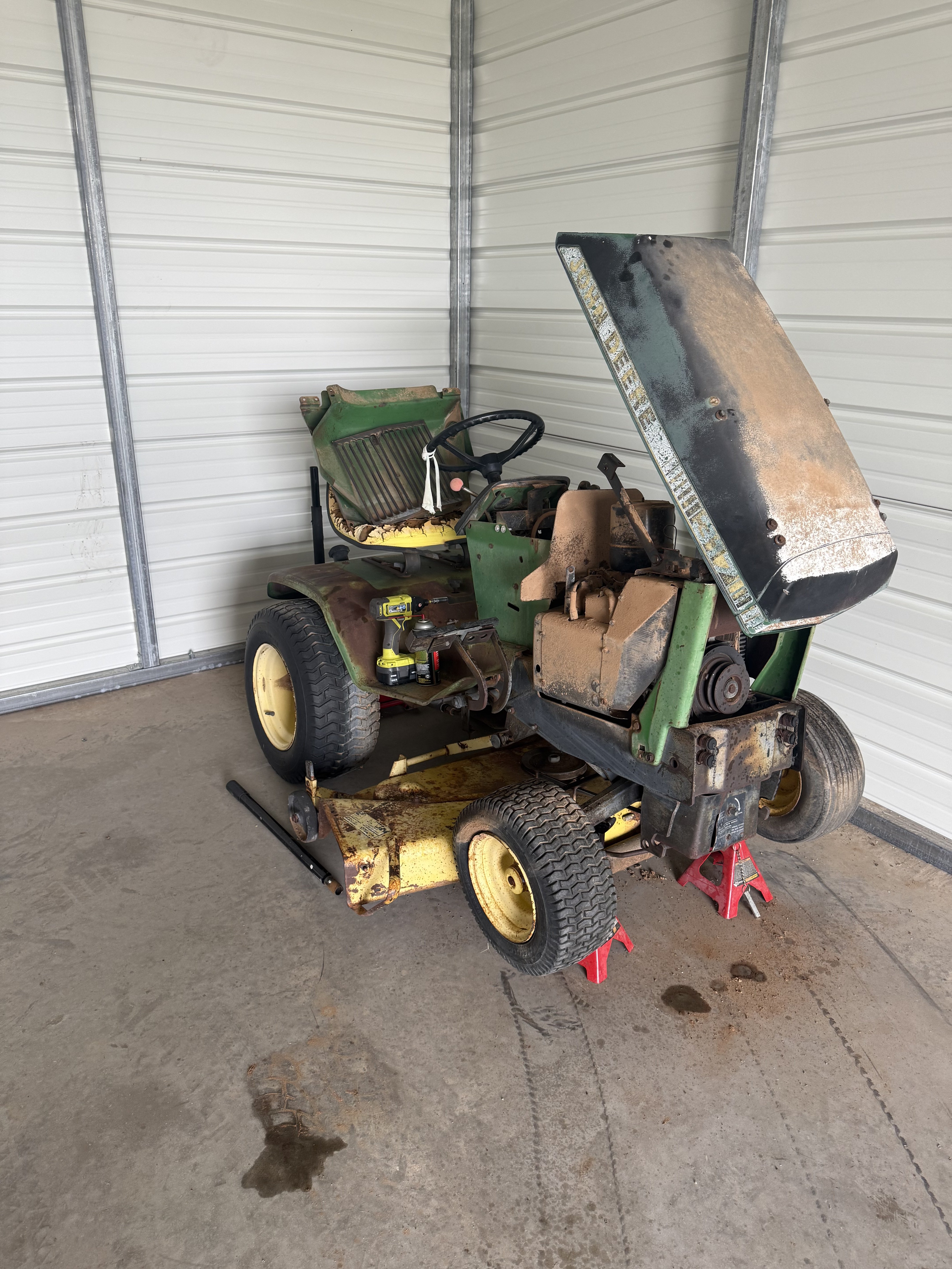

Hi All
Well I finally got my 317 over from my father in laws house to my shop
. Plan on doing a full restoration. Any tips or suggestions are welcome. I have no idea if it runs yet and for some reason it seems to tilt to the right in the front. I’ve worked on cars my whole life but this is a first for me .
Where should I start? It appear to be complete minus some knobs here and there. I know I need to get a hold of some manuals and get familiar with it. Hoping I have the series 2 motor.

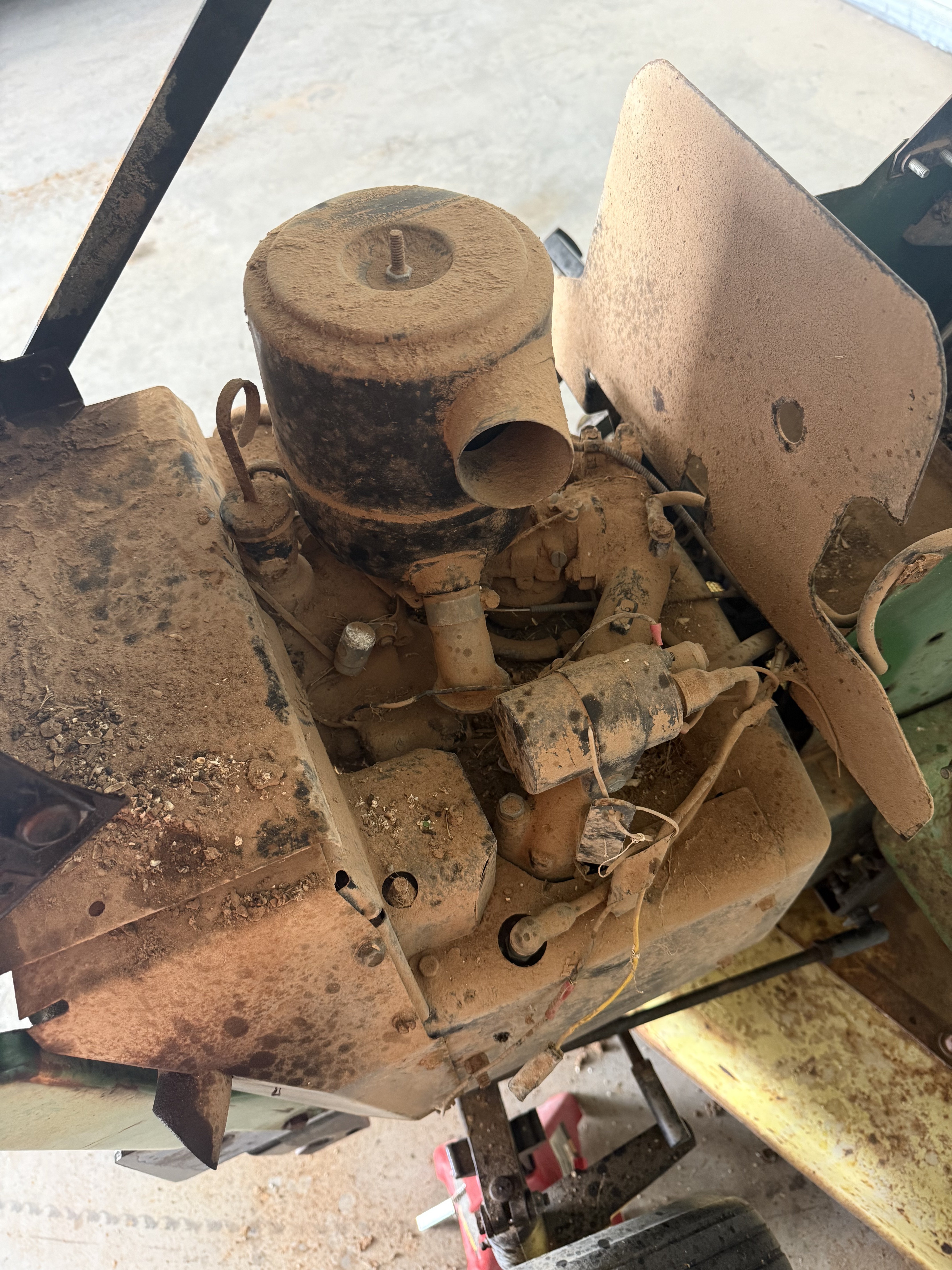

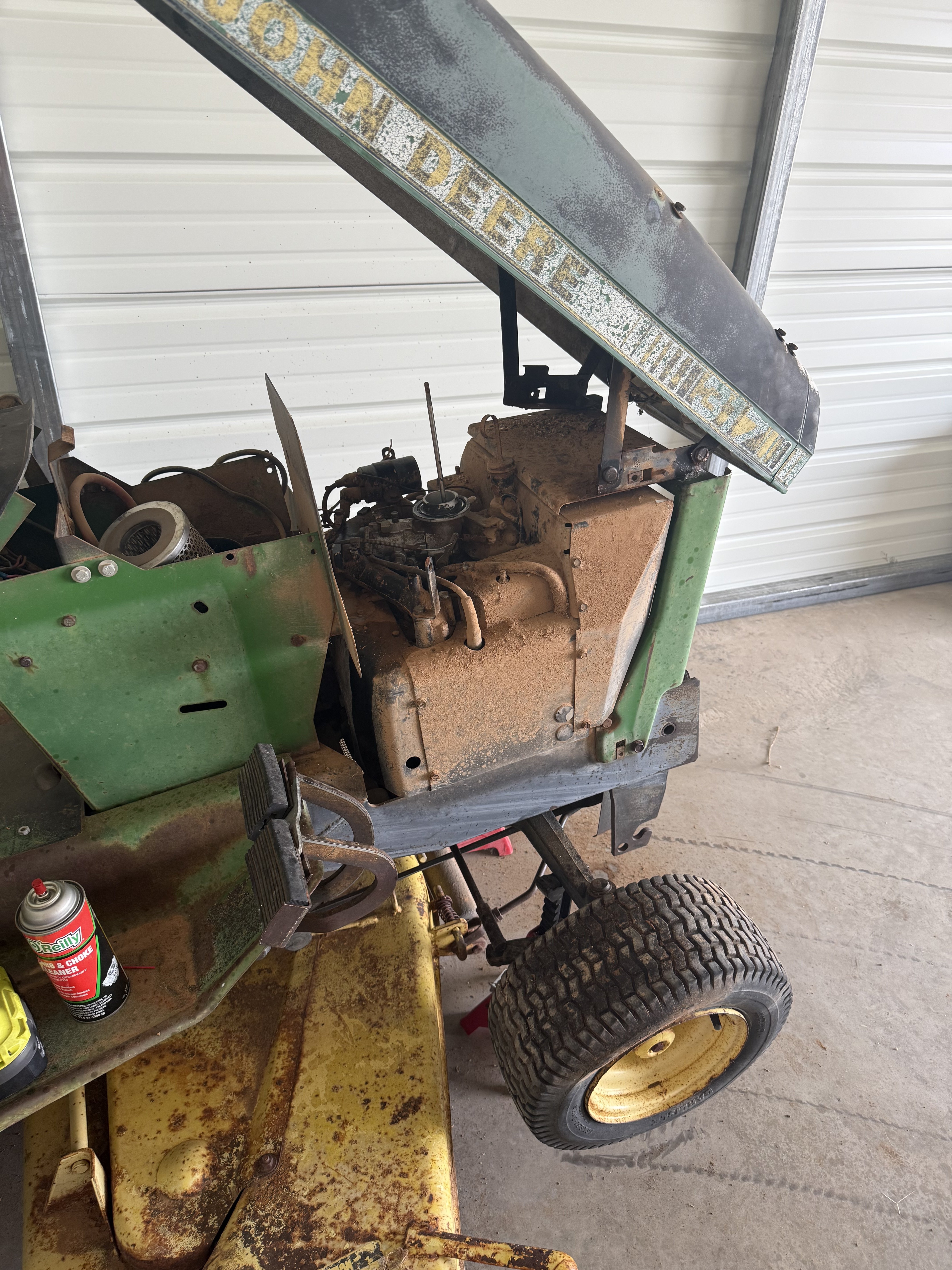

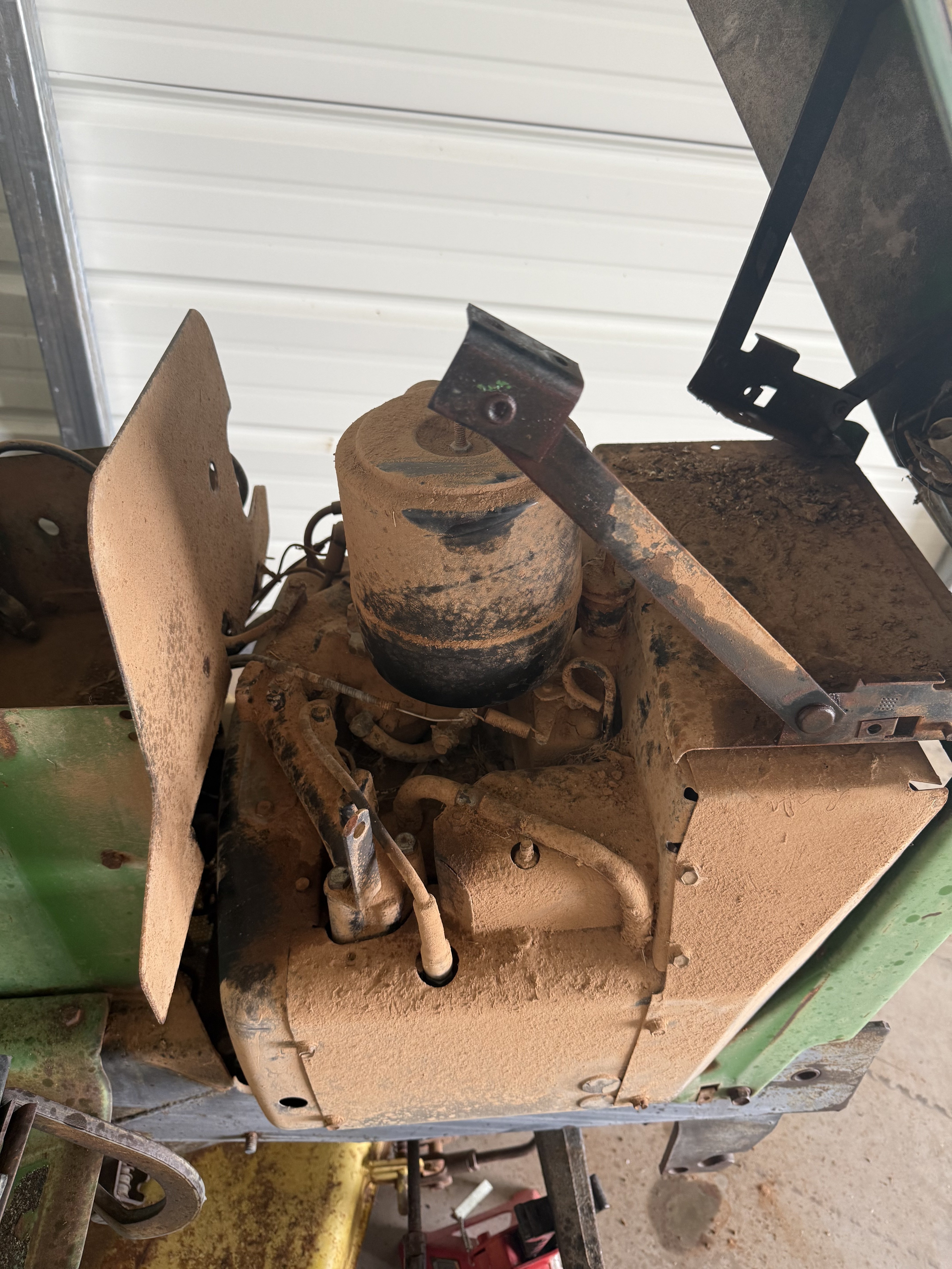

Ok so I was able to do some disassembly today. Unfortunately I believe I have a series one motor as there’s no oil filter I can find. Also I may be doing an engine rebuild as this thing has zero oil in it at all which is not surprising but it sure would’ve been nice albeit a bit delusional to see a full stick of oil on it haha. Apparently the hood bolts that hold the hinge must’ve broke at some point bc it has bolts going through the hood to hold the hinges so I’m thinking that was a homemade solution as I haven’t seen that one before. Also bone dry on hydraulic fluid which again, I’m not all that surprised by. No idea how long she has sat for. Surprisingly lots of poop but no nests so that’s a win lol

If I remember correctly, The series 1 or 2 didn't have a oil filter. Series 1 had the oil pump pickup in one side of the engine, causing the engine to throw a rod when driving on a ditch bank opposite of the location of the pickup. The Series 2 had it in the center of the engine so it would pick up oil when driving on slopes.

Welcome to the Garden Tractor Forum! Looks like you have some work to do on that 317! I once made a half track tractor from a John Deere 317. You likely have a series 2 KT17 engine.

Is the engine tag still on there? You can tell by serial number. You can get the service manual free online on the Kohler website.

As long as the engine is free you will save it(maybe)look for a broken frame where the the rear end bolts to it. I have seen several broken, a piece of angle iron and they are an easy fix.
Well good news bad news. good news is the motor turns freely by hand without any issue. In fact how freely it turned gives me pause , but it made zero weird noises so that’s good. The bad news is a storm knocked out our power as soon as I started to work on it in the shop :ROFLMAO: all my wrench time yesterday was dedicated to my cub cadet .
