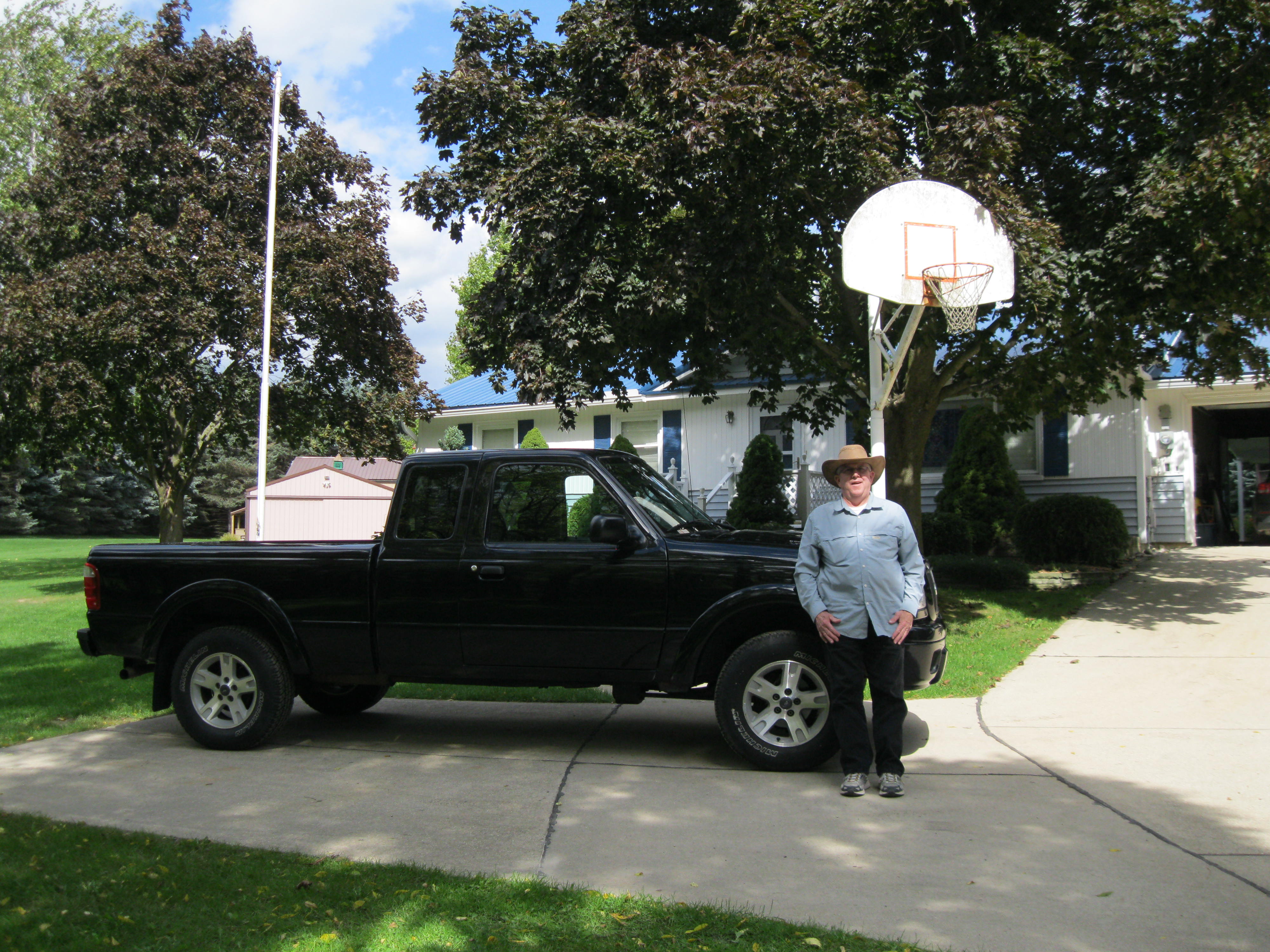

My brother got a 2005 Ranger in Stockton CA in 2016 with 100k on it. It wouldn't pass CA inspection because the check engine light was on. Ended up both converters were plugged. In CA, emission work has to be done at a certified shop. Two shops told him not only did it need new converters, it also need the top end of the engine done (they claimed that was what caused the converters to plug). Estimates were in the $4,500 range. I flew to CA and we cut the converters off, punched the guts out and welded them back on. I took a 6,000 mile "road trip" home with no issues. Now have 160,000 on truck and only thing is, the check engine light is still on. You think it would have burnt out by now.
