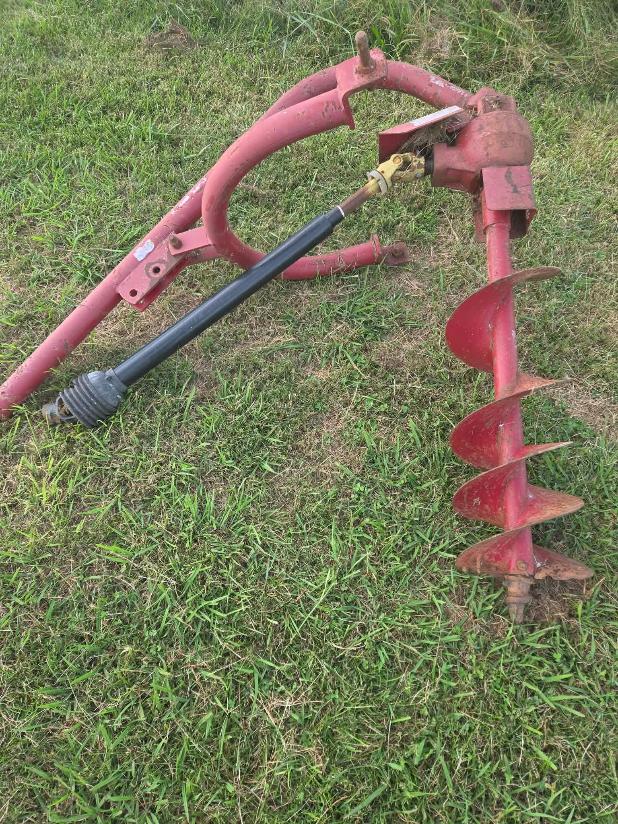

Hey guys, I bought a 3 point hitch post hole digger, the decals are very faded so I can't see anything there, I did find a photo of one like mine and it was sold new by Tractor Supply, but some company made this for TSC and that is what I'm trying to find out, when I need parts for it a make and model would help out a lot. This one sorta looks like the Speeco model 70, I heard they made these for tractor supply for a period of time as did other companies. A picture of mine is below, any help would be appreciated.

I asked AI, this is the result.
"Based on the specific loop-style shape of the red frame and the layout of the adjustment brackets, this unit strongly resembles a Speeco or Country Pro (a brand manufactured by YTL International and widely distributed through Tractor Supply Company).
Similar models using this exact frame geometry include:
  • Speeco Standard/Heavy Duty series 3-point diggers
  • Country Pro
    3-Point Post Hole Diggers (such as the YTL-007 series)
  • Older Howse Implement or Leinbach models, which also utilized similar tubular red arch frameworks. [1, 2]"

I have one like that. Mine is a Bush Hog brand, I can look up the model numberi if that would be of any help, I do have the manual that came with it. I do not know who the actual manufacturer was.
