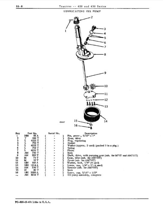

Have been working on 420C engine... New to me, aquired non running.. Have too low oil pressure! Gears in pump have play between teeth. Parts book shows both gears... Idler and drive drive gear and shaft shown as one piece. My pump drive gear is keyed to shaft. Is this original part or something someone has manufactured to repair pump? Gears fill cavity in pump but there is play between teeth! Thank you for any insight

The pump shaft and pumping gear are not to be dissembled. You only remove the driven gear that mates to the camshaft gear. The parts book shows the pump shaft with the gear on it as one part and the idler gear as a separate part. The pump drive shaft and pumping gear will be one piece. and the idler gear that mates with it needs to be replaced as well. You may have trouble finding parts or even a complete good used pump.
The spec for between the teeth of the gears inside the pump is .0005"" to .002".
The spec for clearance between the gear faces and the lower cover is .002" to .006".

The pressure relief is in that pump as shown in the parts drawing. It is adjusted with shims behind the spring and was discussed in a previous thread about his oil pressure problem. It only limits maximum pump pressure not system pressure. Beyond wear in the pump causing low oil pressure, the system has a bypass filter that needs to have all the parts and be assembled correctly or pressure will be lost. Bad bearings, including camshaft bearings, are the other key areas where system oil pressure losses can occur in those engines.
