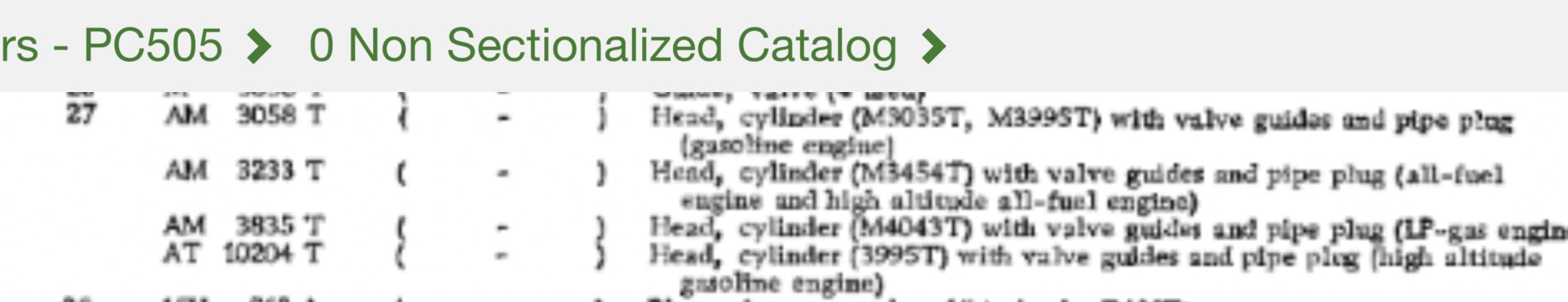

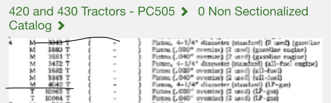

430 John Deere
how much compression is desired ? tractor pulling ? It will need the worn cam and followers re-ground as well.
All fuel was 5:15 to 1, gas 7:00 to 1 and LP compression info is scant to find .
There are four different part numbers for cylinder heads . With three variations in castings .
