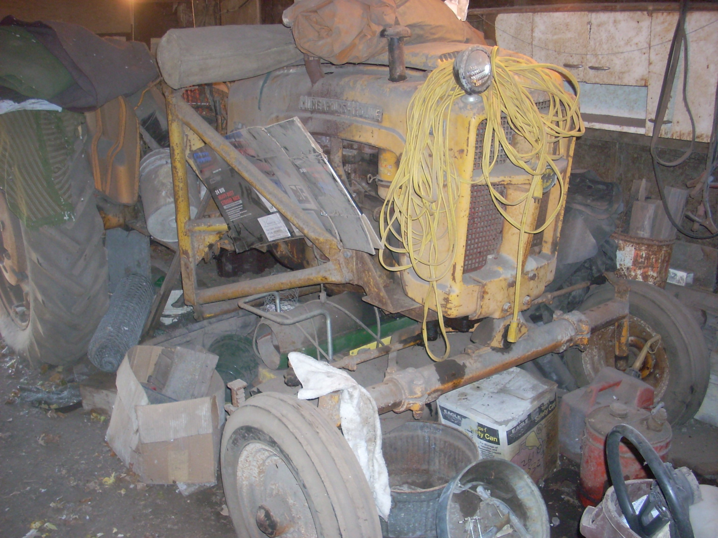

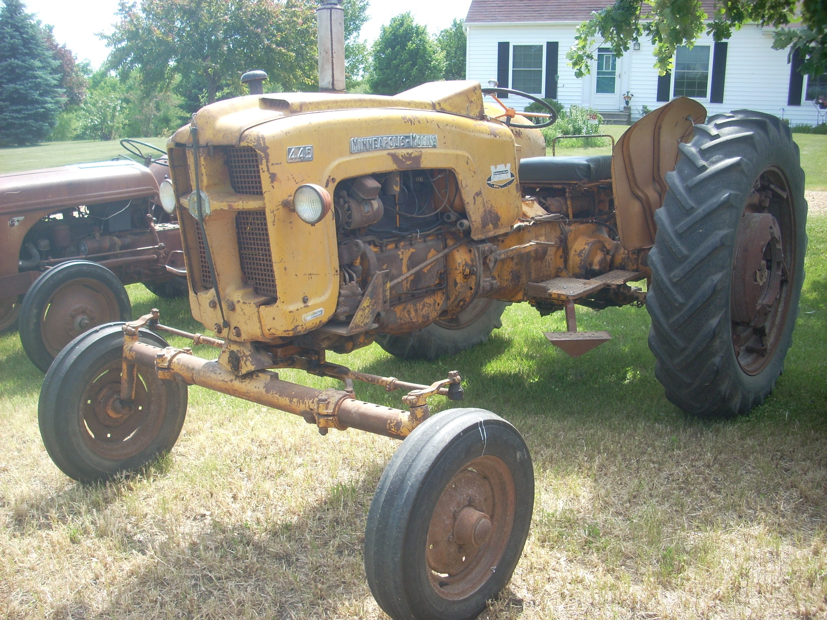

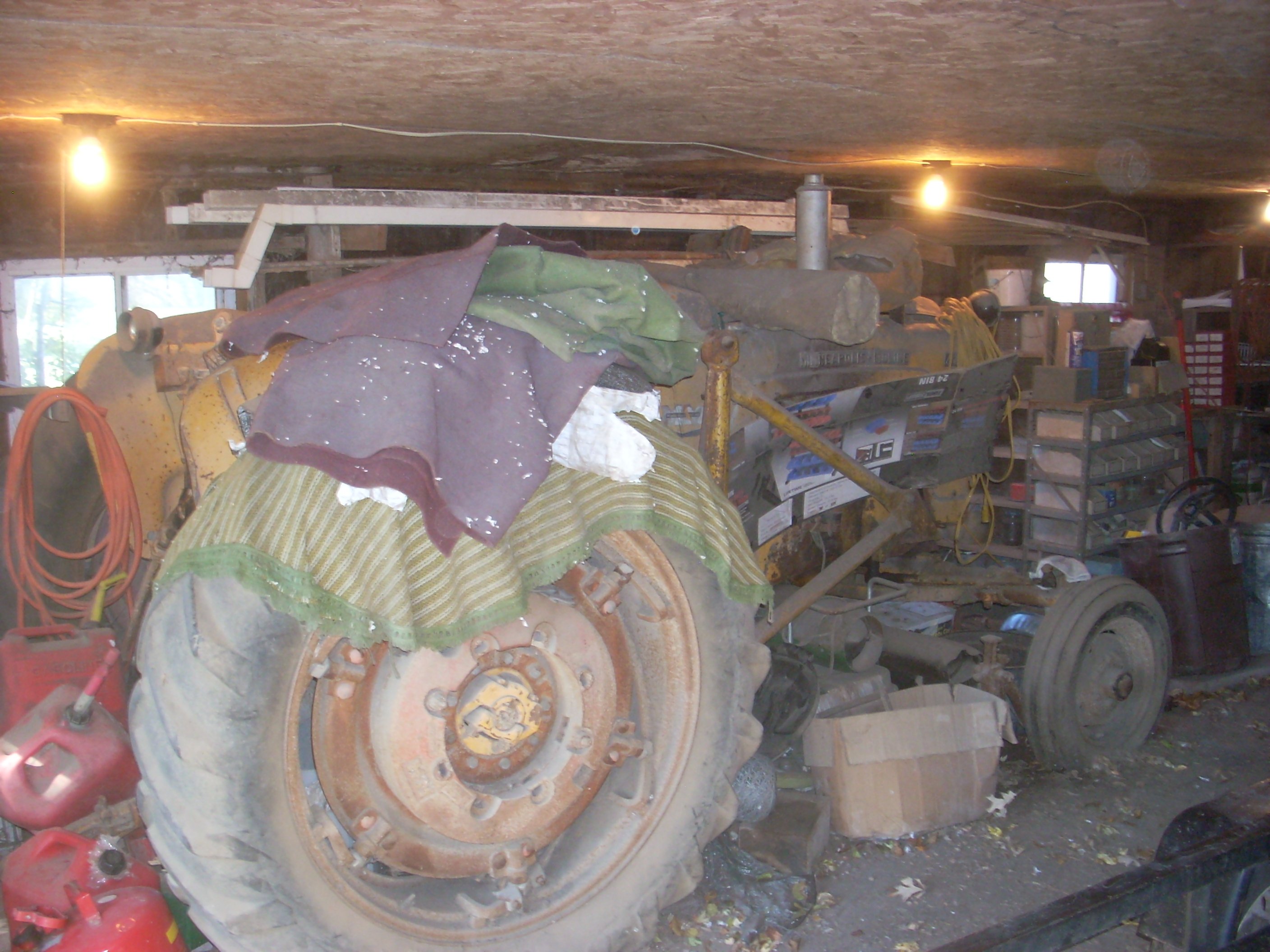

When I got this one in 2018, it had been stored inside since some time in the 1990's, I was told (first two pics). It was not stuck. Had the carb rebuilt, replaced the gas tank, and the usual tune-up stuff. It runs great.
