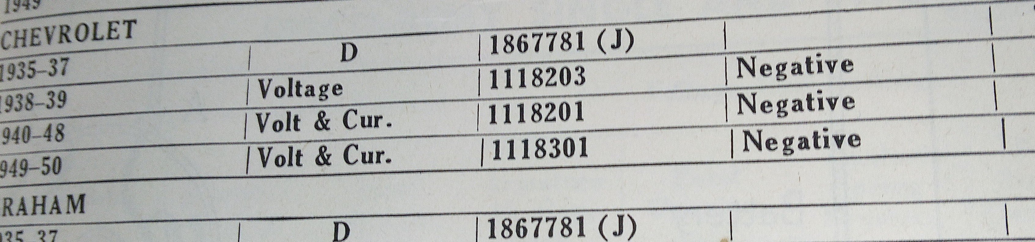

That’s interesting but as I said never saw it , never learned it . Never had a Chevy between the 1940-1954 year range because they were not in my interests . Failures like Nash , Packard and Studebaker were never interest to me either so I never payed any attention to them either .
