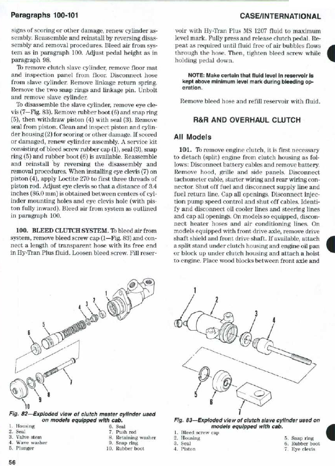

Hi, as another Member mentioned since you have a cab on you 695, it has a hydraulic clutch and the hydraulic part is the first place to check.
See a couple pages below from an CIH Service manual.
There is an inspection plate at bottom of clutch housing but since you have a 4X4 the cover for front drive shaft will have to be removed to access the inspection plate. If you have a helper, put on parking brake, chock rear wheels and look at clutch mechanism through the inspection plate and have helper depress clutch pedal and see if clutch release bearing is depressing the fingers on the pressure plate.
According to CIH manual your 695 should have the 12 inch Rockford clutch but may have the 11 inch Laycock version. When you look through the inspection plate you can tell which model clutch by comparing to photo in the pages below. Common failures are clutch release bearing seizing and wearing off the ends of the fingers or finger adjustment screw backing off.

On my newly acquired Case-IH 895, there is a sheet metal panel/cover between the windshield and top and sides of the instrument frame mounting on my XL cab. Don't know if the regular cab is any different here or not. Twist retainers on either side. Remove it and you are looking down at the fuse panels and the clutch fluid reservoir.
The low-full marks are on the side of the opaque plastic fluid container sitting on top of the cylinder that forces the clutch to function. Special note in the serv. manual, and on the side of that container to use Hy Trans "extra" fluid. The difference between full and add fluid is only about 1/4". Don't know the source for the "extra" rating on that fluid.
