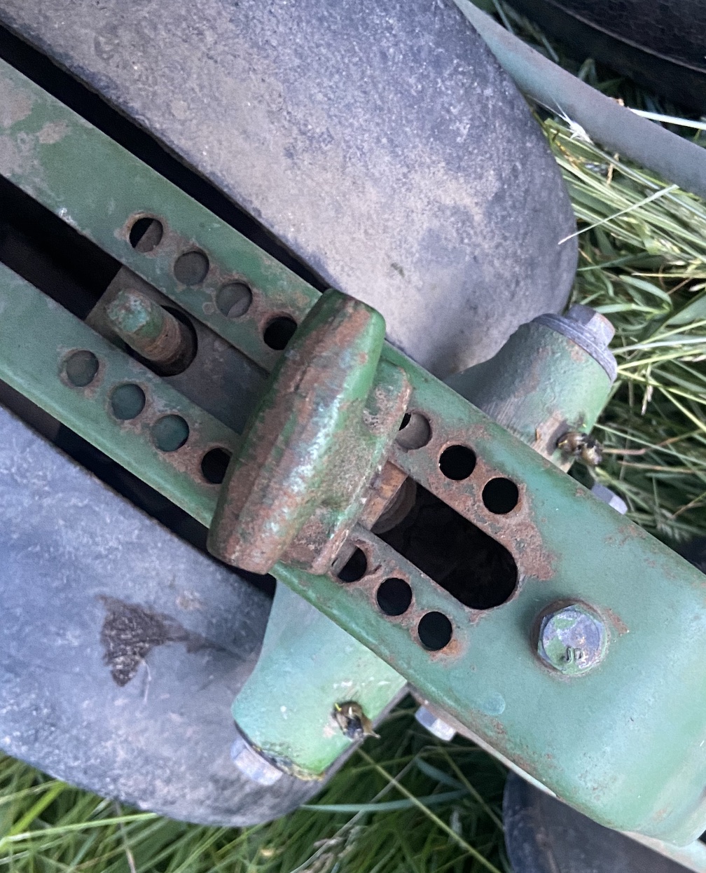

3. Planting Depth-What do these settings mean in inches? I want to plant at 1.5 inches. I have it set to 3 holes on each side. About how deep should this plant beans at this setting?

3. With wear in all the linkages not all rows will even be the same. Sit the press wheels down on 2x4 and see what setting gives you the right depth.
