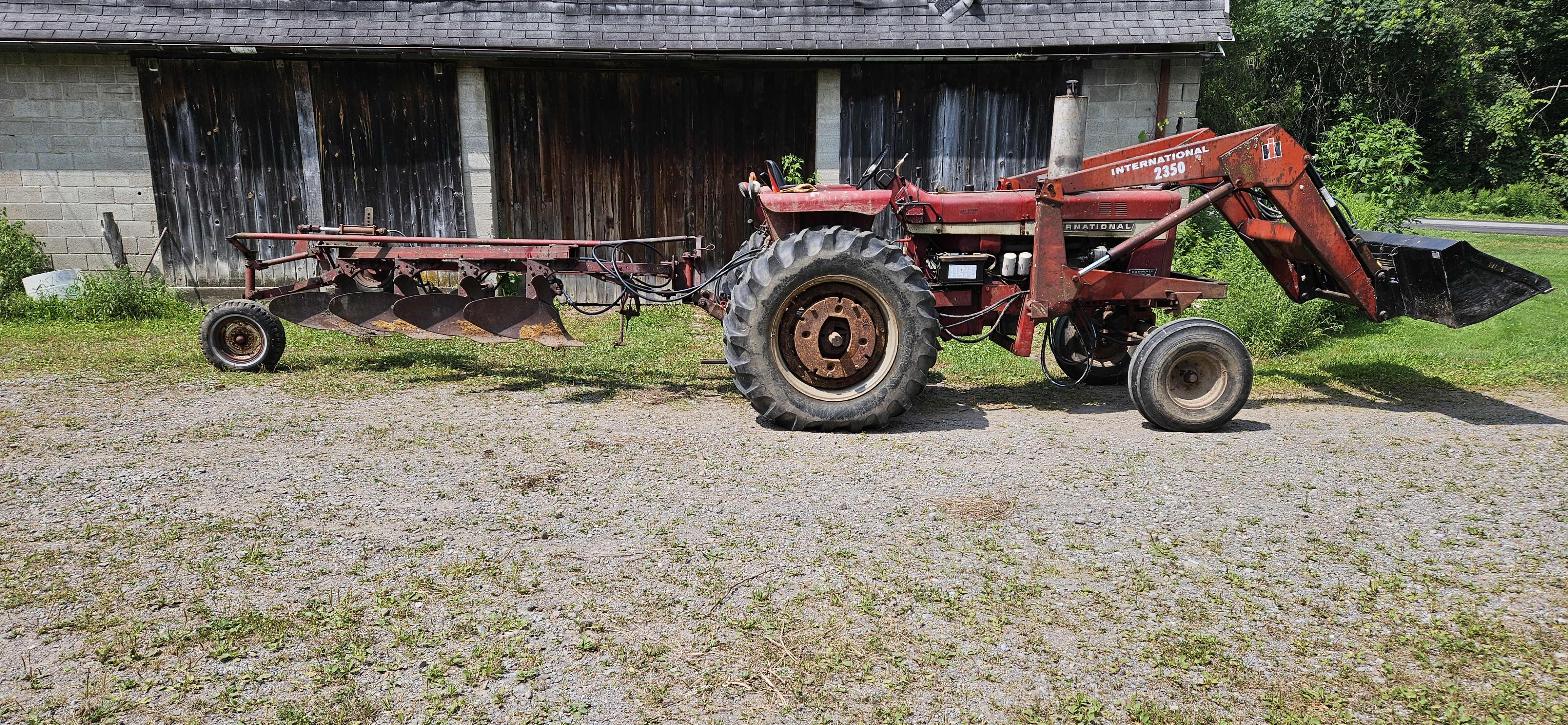

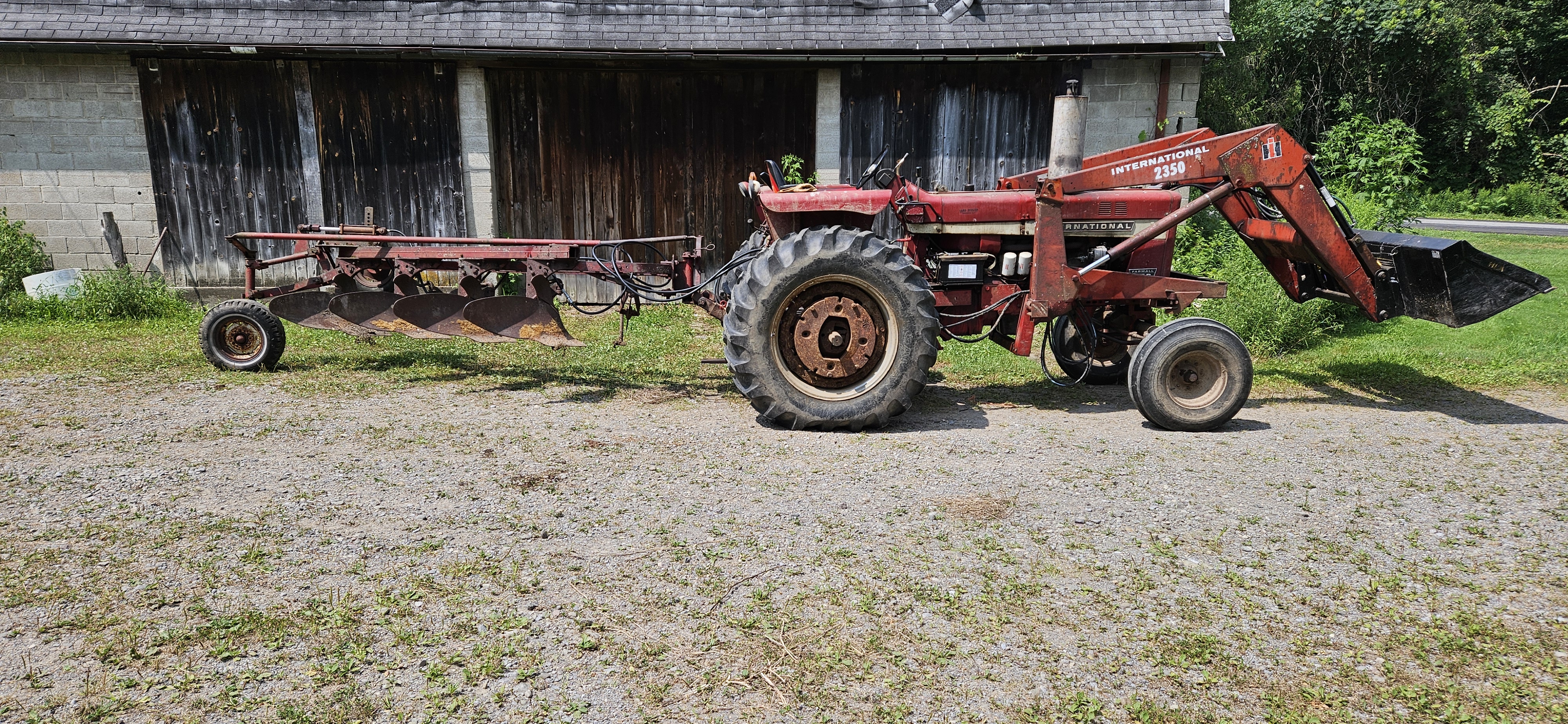

I had a can of Tillcoat to burn up & have neglected the bottoms on the 540 plow for a while. Figured it was time to clean them up. The front two shares were worse than the last two, so I ran it nose down to cover more surface area. The shares & shins came out glossy with that nice waxy feel to them. The moldboards at least came out smooth. Those are Case IH Earth Metal & really take some work to get a good polish to them.
Enjoy!
Mike
A little before & after. I don't mess around between plowing & coating, so I didn't think to get pics before painting them.

Pretty ⚡️cool video .⚡️ Suggest , The number one moldboard is loose ,( rocked back ,if the matters to you
You can grab the moldboard, by the edge & wiggle it a couple inches either way. I've never seen one so worn. It did come from a potato farm & was buried for most of it's working life. No's 2 & 3 are good yet & 4 is a bit loose, but not too bad. Didn't trip any of them when hitting the top of the mountain in the beginning of the vid.
