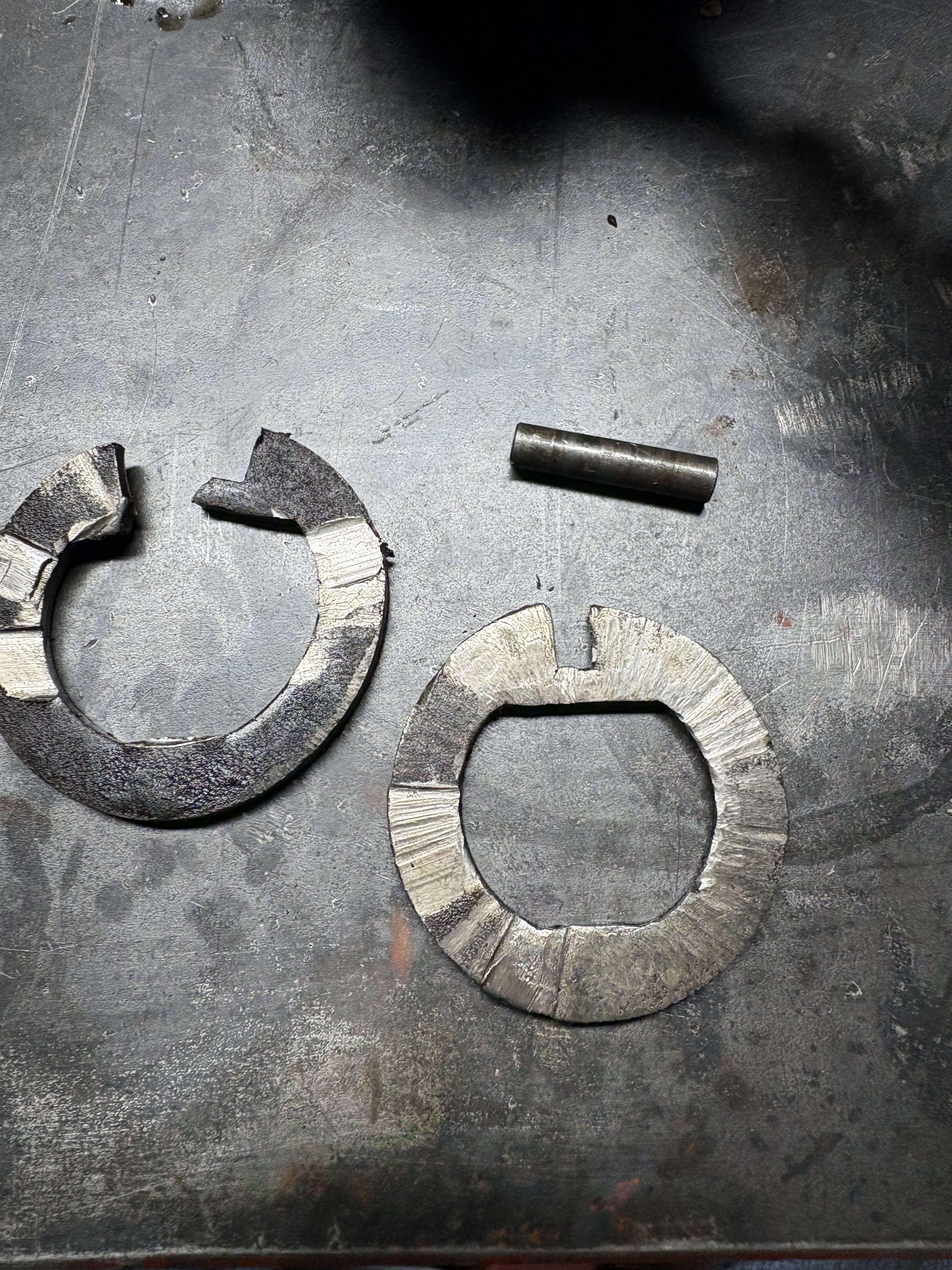

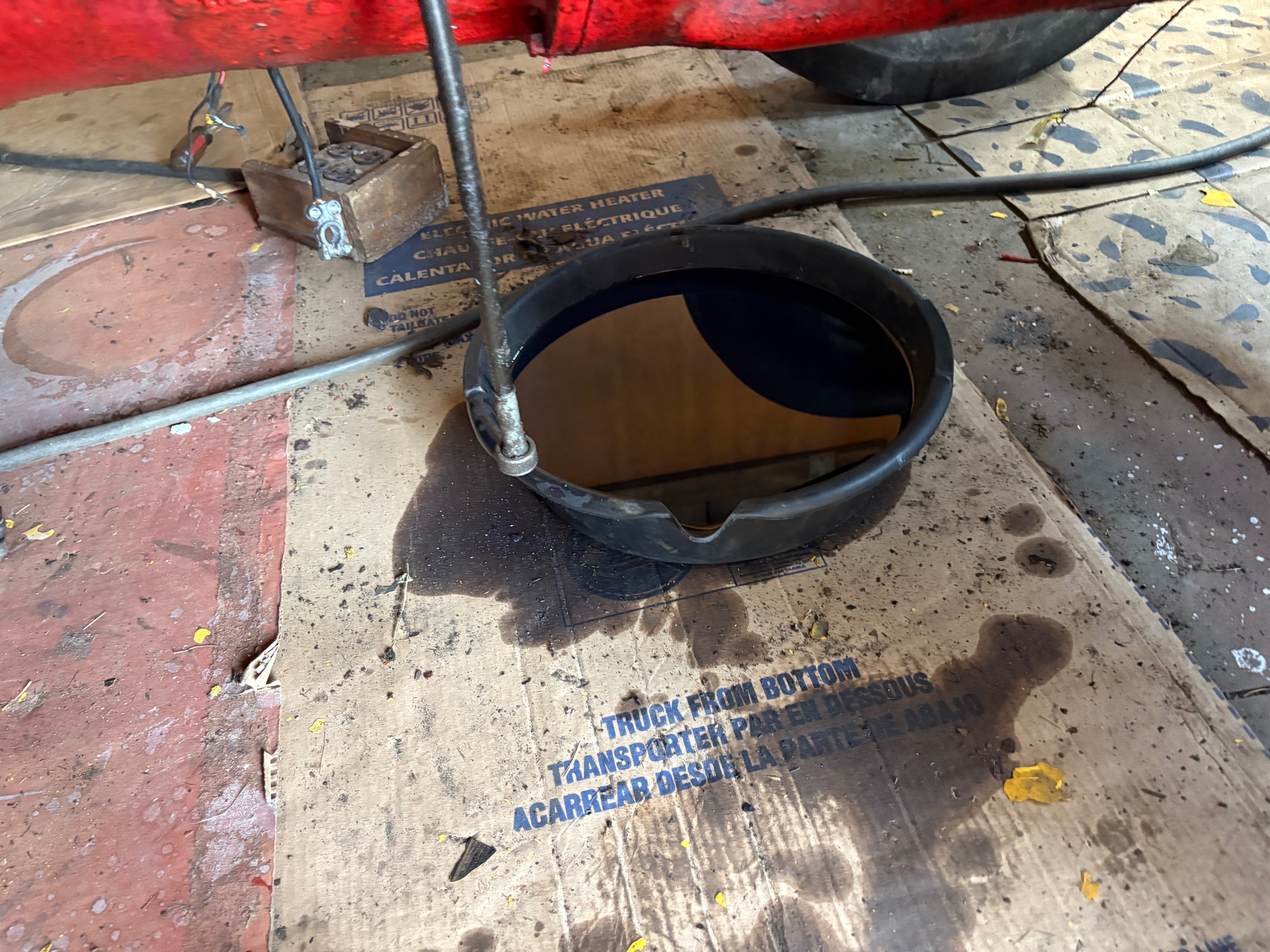

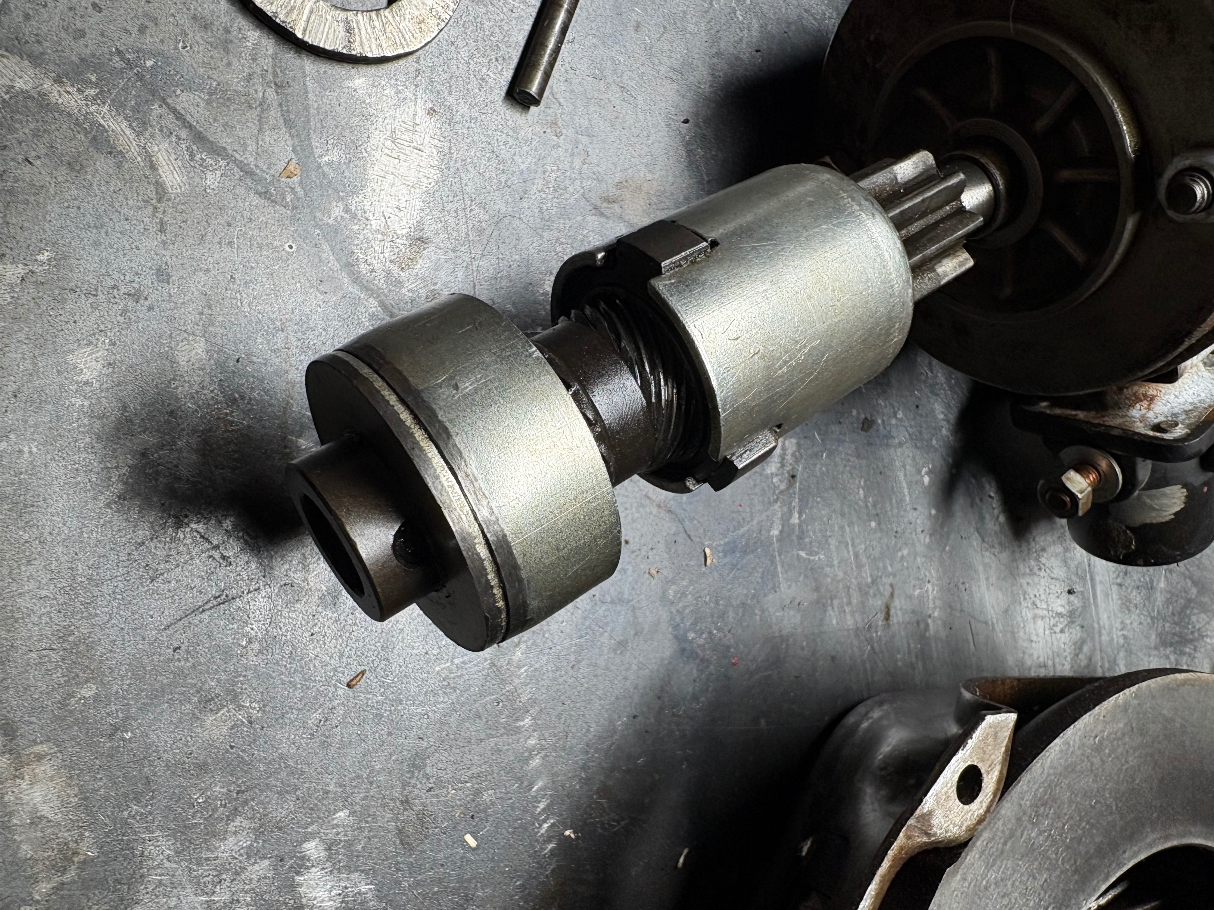

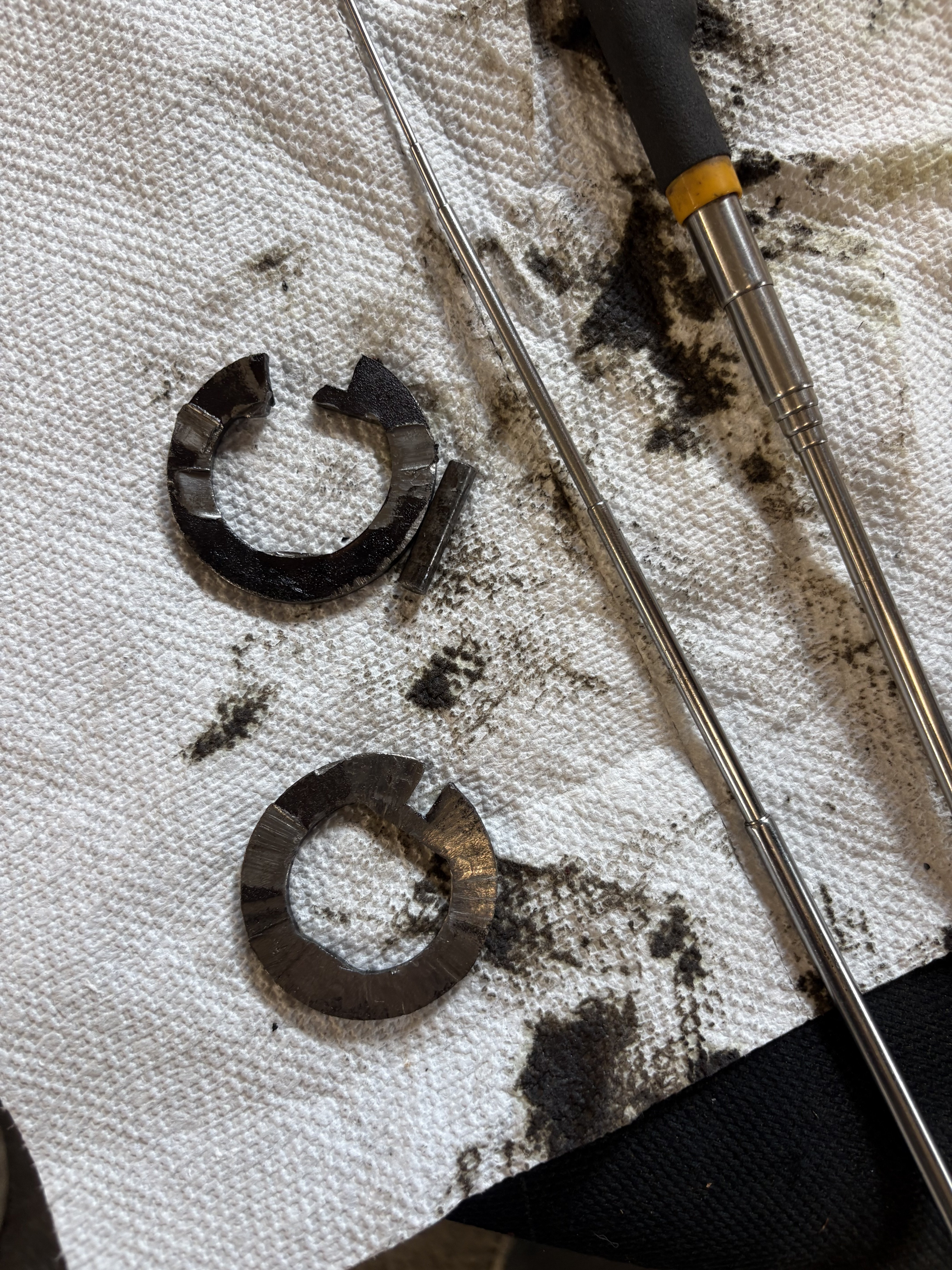

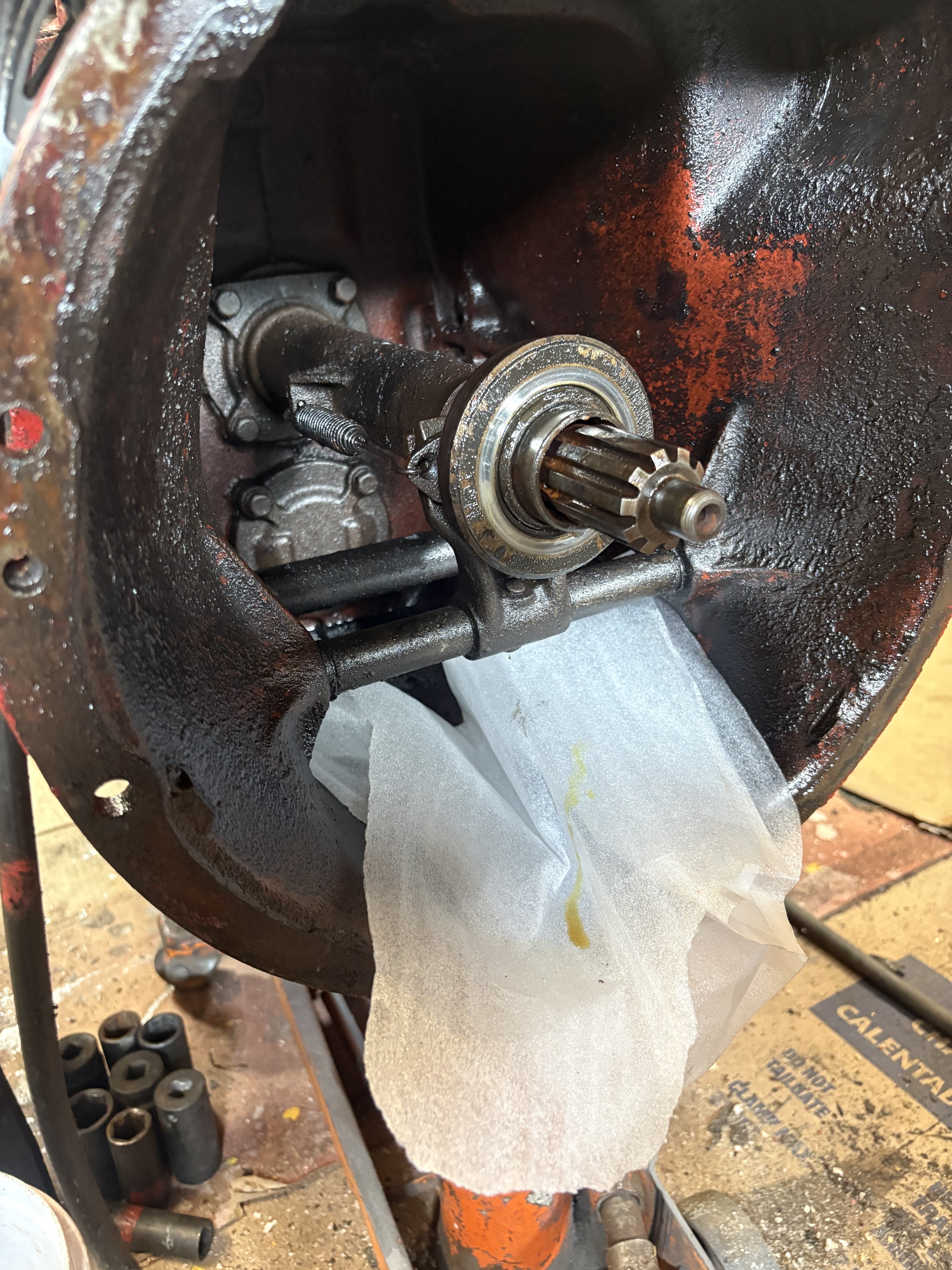

Tearing apart and 8N that wouldn’t turn over was making some noise in the bell housing when I got it apart I found these loose pieces in the bottom plus about half a gallon of oil. Any help would be appreciated. Thank you.

Oil is there because the drain hole is clogged up. That hole should have a cotter pin in it to help keep it open so oil can drip out. The parts are likely to be bendex parts
I believe the oil is leaking out of the transmission through the throwout bearing tube and I don’t believe it’s supposed to have a half a gallon of oil in there and when you said Bendex what did you mean? Thank you
Bendex is the starter drive and common for parts of it being in there as for the oil it can come from either the transmission seal or the rear main engine seal or both. The bell housing has a hole in it at the bottom to drain that oil out and if clogged that happens
