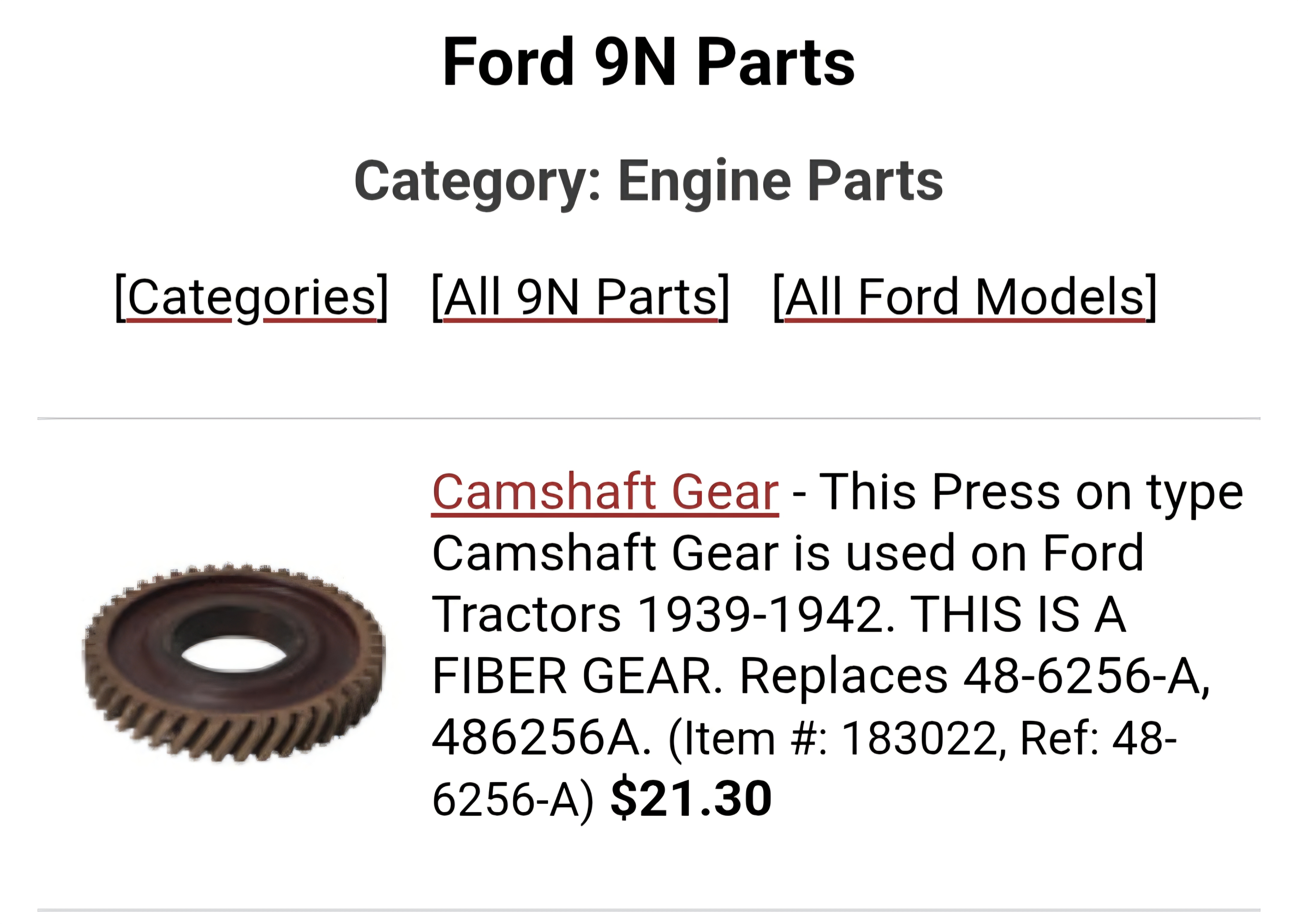

I took the distributor/coil off and the slot where the distributor goes into is not going around. I'm guessing the camshaft gear bad. I have read other posts where they made press on and bolt on gears. Before I tackle this project just want to make sure both types of gears are available. Is there certain years or S/N range where each gear was used? I can find the bolt on ones but haven't seen any press on ones. Thanks!
Hi dwb-ne,
Sorry it busted. This site has the pressed on gear---says from 39 to 42.
Prolly good to drop the pan to clean, and loosening the mains a bit to drop the crank gear a little so the new cam gear can line up properly.
