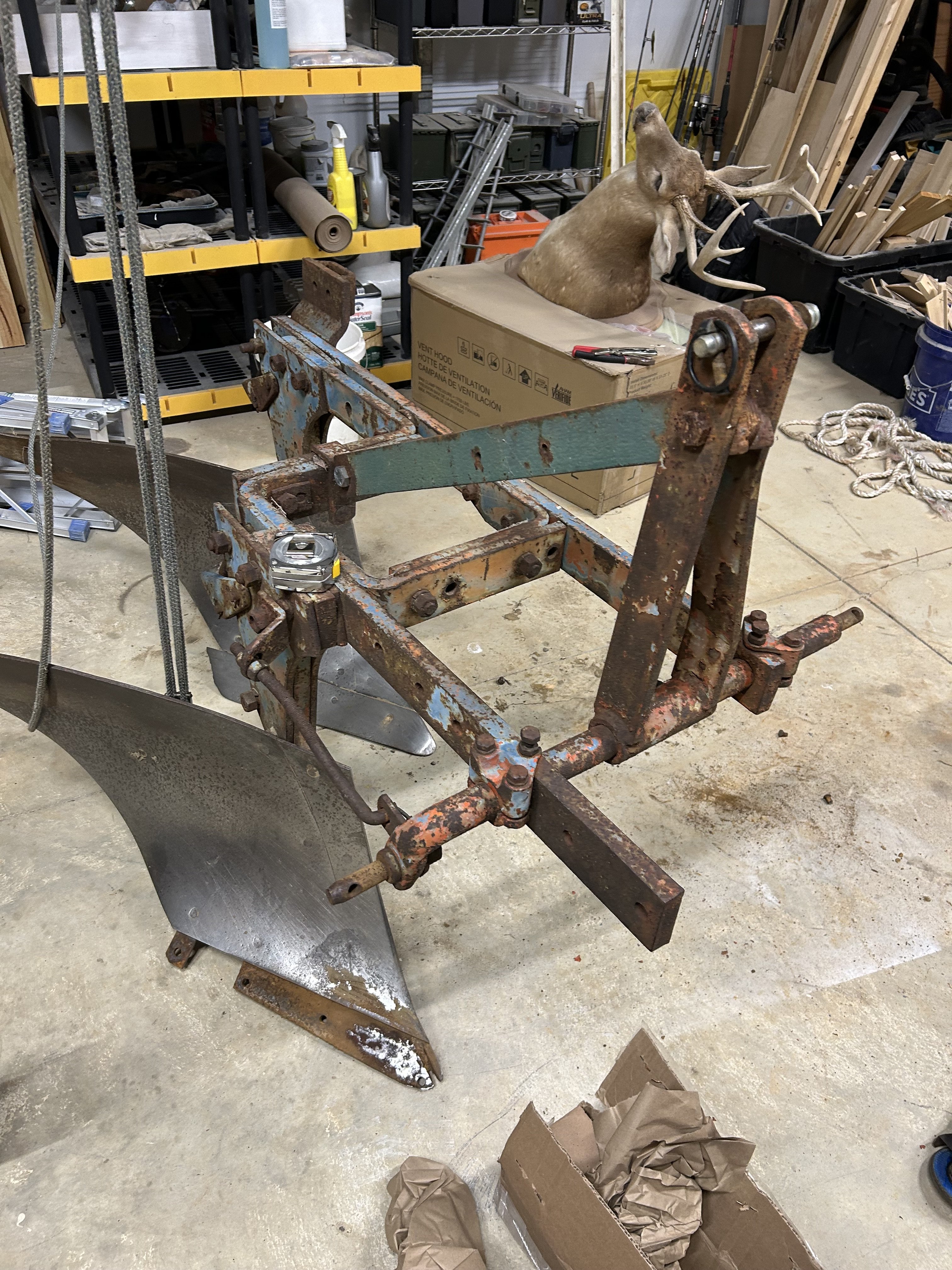

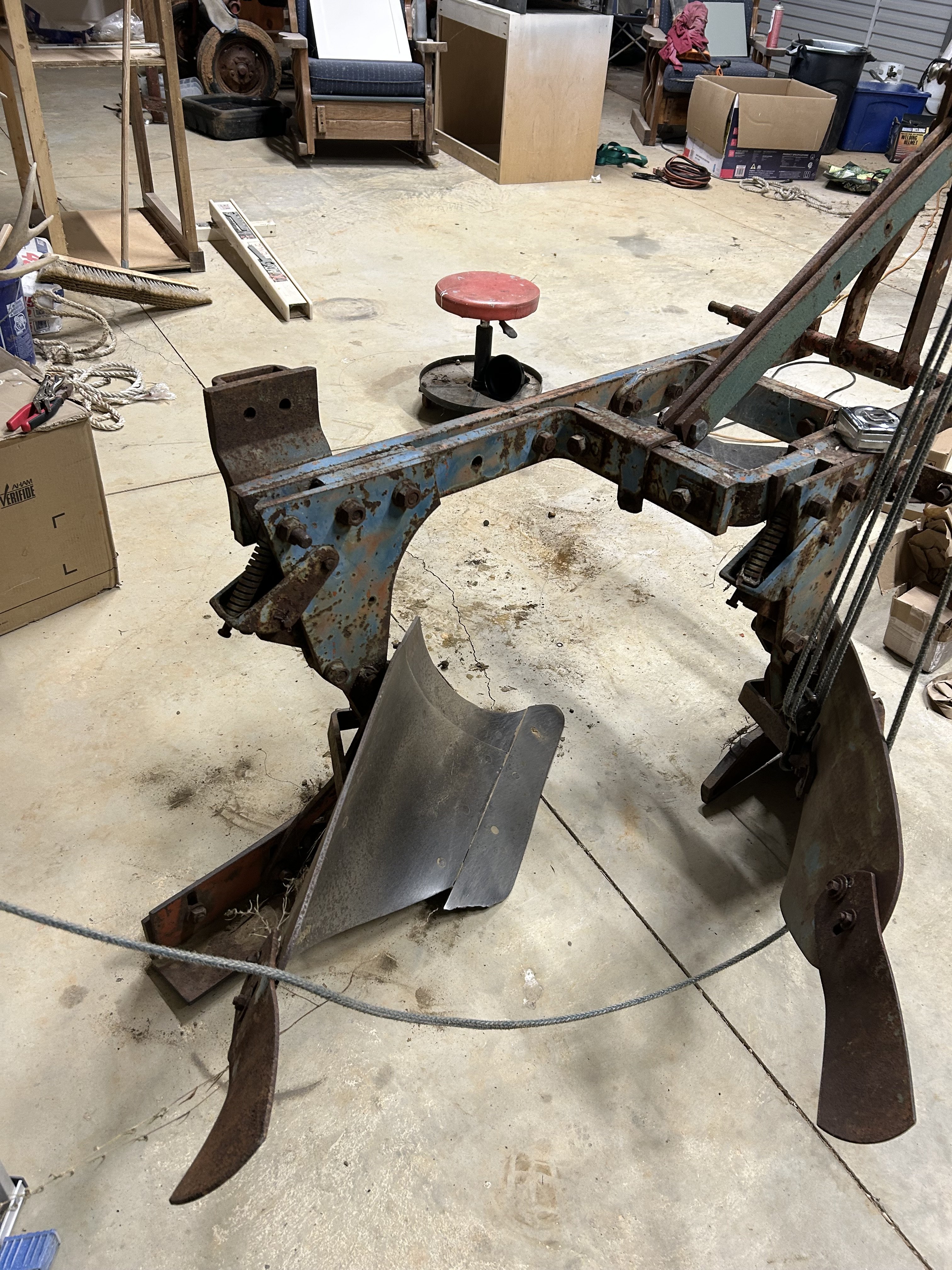

Looking for help to identify a my plow. I’ve looked everywhere trying to order new shares the one I pulled off had 5 bolt holes but only 4 bolt holes on the plow. It is 14” across the center of the frame. Any help would be nice thanks

It looks to be a 70 series from the Early 1960's
I Checked my manuals and it looks like the 73 Pictured on the bottom of my scan

There so many shares and moldboard designs by mfg.
There are numbers on the shares and the moldboard s that I’m sure you will need to find the replacements. First question anybody you contact will ask is what are the numbers on the share and moldboard s .
Additional information
I have an antique Allis Chalmers which I got parts from David Sousa of Spring Valley Wisconsin ,he is probably the best source of information on Allis Chalmers plows that I have found to date. He said he specializes in snap coupler plows .
Other excellent people resources
Watch the videos on you tube by John Garrd and Dylan Lynch
Also YT has Steve Smith from republic Ohio.
Plowox ,Salem ohio mfg. of plows shares and moldboard s
Best I can say abou5 this . Good hunting
