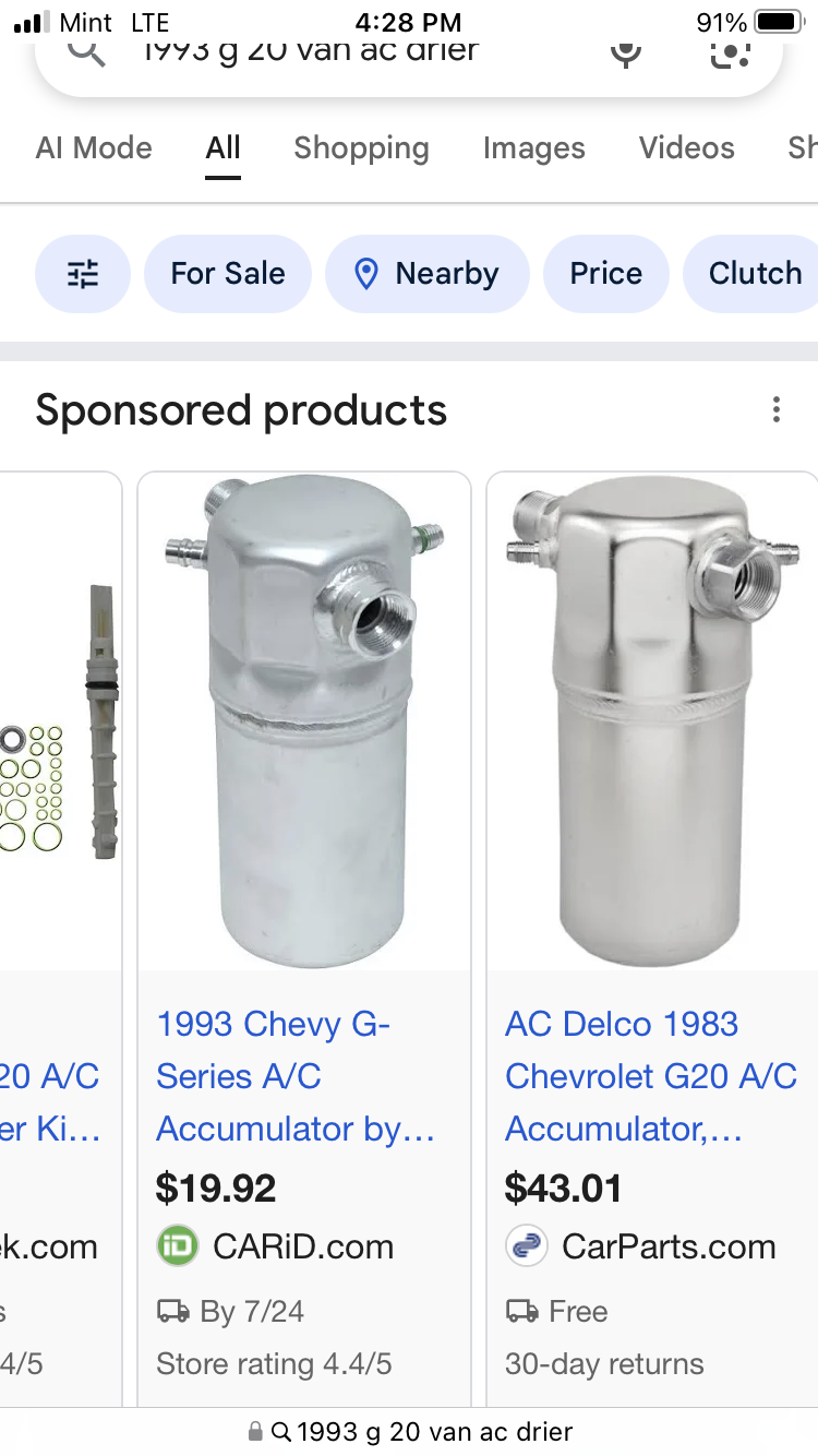

1 Replace dryer 2 then vac. 3 test that it holds the vac. 4 then let the dryer do its job and fill it with r134a

1 replace dryer add a couple ounces of the correct oil for the compressor if you haven’t you said there was a leak.
2 vac
3 test vacuum by closing manifold valves and waiting 10 min
4 charge be sure to bleed manifold and not lose your vacuum.
