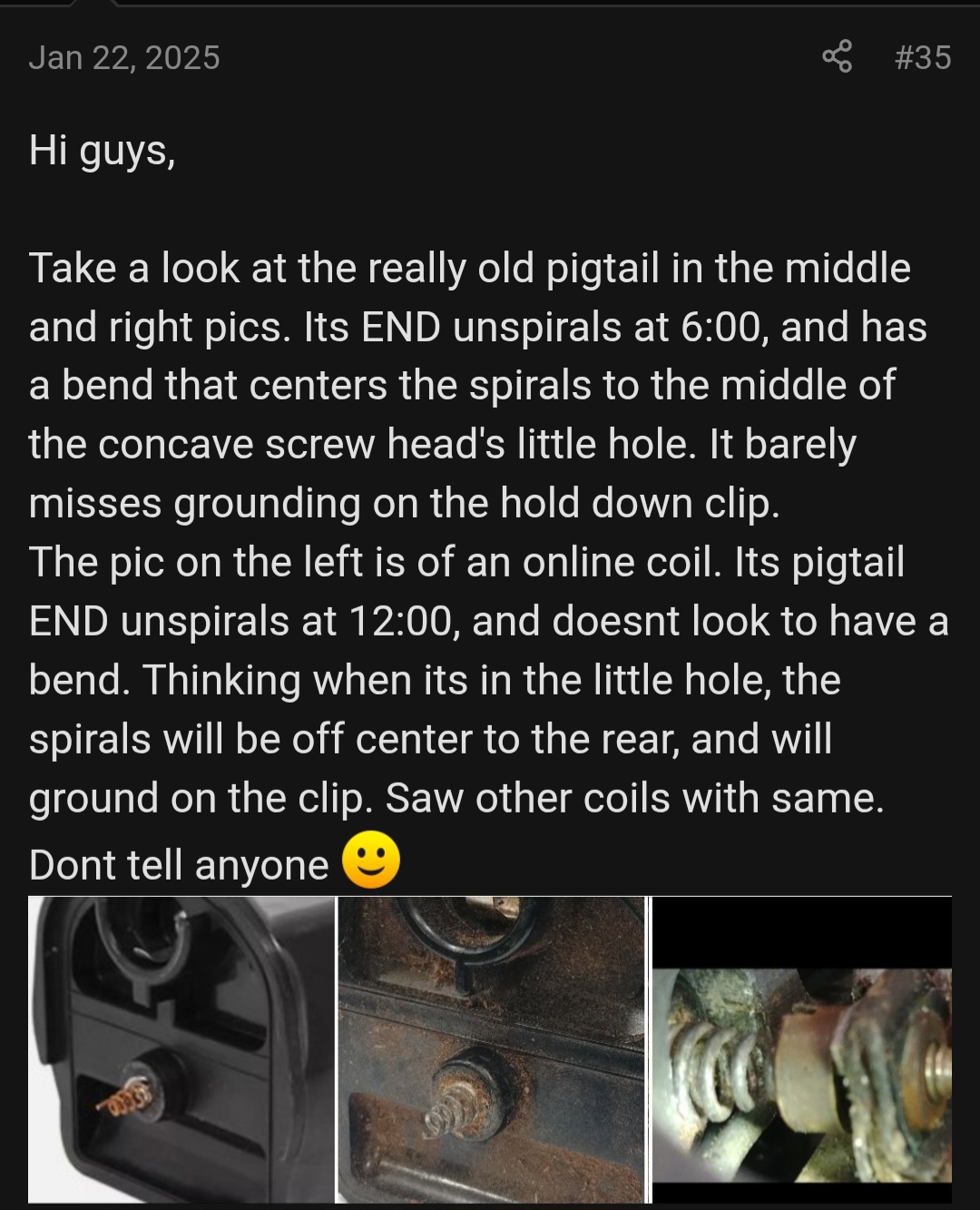

OK, it sounds like we have a terminology problem. Your bowl that is a filter of sorts is the fuel shutoff and sediment bowl. There is also a bowl on the carburetor which is the part with the plug on the bottom that you removed to check fuel flow.
Now if you have no spark we're back to the beginning. When I asked if you understood how it worked, if you did it should be simple to get spark back. Check to see if you're getting voltage to the coil with the ignition switch in the on position.
Take a look at this:
