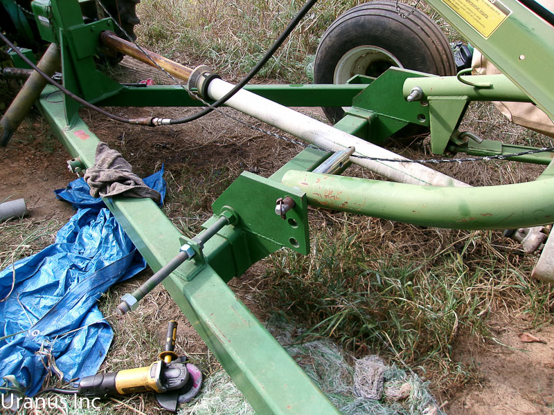

I've got a 3 point Kverneland round bale wrapper that I'd like to convert to a tow behind with a tongue and axle. I also have a couple PTO hydraulic pumps and a hydraulic tank sitting here that I bought at an auction pretty cheap several years ago that I'm thinking of adding to it so it doesn't run off the tractor hydraulics. The reason for doing this conversion is so it is easier to hookup and so it can be run with smaller and older tractors that may not have the hydraulic capacity to run it, example Case VAC and Oliver 550.
Has anyone here ever mounted one of those pto style hydraulic pumps to the unit and then connect it to the tractor via a short PTO shaft rather than mount it directly to the tractor PTO? My main thought here is ease of hookup and not having to manhandle the hydraulic pump and secure it on the tractor PTO every time it's hooked up. It's a lot easier to simply hook up a PTO shaft.
I was thinking about a short piece of 6 spline PTO shaft stock running through the pump and fastened on each side with a spacer and bolt or keeper of some type so it won't come out and then the PTO shaft mounted on the front going up to the tractor PTO.
Just picking your brains here.

I’ve done exactly what you describe on a firewood processor. Length of six spline shaft through the pump with a shaft collar on each side. Cut a groove in the end of the shaft for the cardan shaft to lock onto.
I also have a landscape rake on my little Kubota that uses a pto pump. There isnt room on that tractor for it to fit. I made a bracket for the pump that bolts to the drawbar, and use a double ujoint yoke to a stub shaft in the pump. The slip action ends up in the pump, but I will never put enough hours on for it to be a problem.

I would mount the pump driveshaft in a pillow block. A short shaft going to the pillow block/flange bearing with a splined stub for holding another driveshaft that would go to your PTO. I believe you want to isolate that pump as much as possible. A fixed, rigid, driveshaft will do it.
Something akin to how my driveline is set up on my Krone mower.
This would keep the stress off the pump mount, and pump bearings.

The only concern I'd have is the short distance and the angle of the PTO shaft as the wrapper is raised and lowered. Yes, universal joints are designed to handle angles, but they have their limits. When the shaft is very short, any change in height is a severe change in angle.
Is this the kind of wrapper you set on the ground and set the bale in? I'd say mount the pump so the PTO shaft is fairly straight when it's running the wrapper. The caveat is you have to be careful how high you raise the wrapper when you move it from bale to bale, AND you probably want to make sure that the PTO is off before you fully raise the wrapper for transport.

The distance and angle of the PTO wouldn't change unless you turn. The 3 point hitch wrapper would be converted to a tow type. The pump would be mounted securely on the tongue at a height the same as the PTO on a tractor. Imagine a sprayer pump mounted on a trailed sprayer with a 3 or 4 foot PTO shaft running from the pump to the tractor PTO. This would be similar, except it would be a hydraulic pump.

They make these specifically for extenig PTOs through those pumps. One of them going through from the back would be perfect: already has a shoulder to stop it coming through from the back, then a shaft collar on front and you're good to go.

If you can, mount the pump with the tip of the input shaft 14" back from the center of the hole in the tongue. This way you'll have equal-angle operation so long as your tractors are set up properly, which they should be. At four feet, it won't take much of a turn for it to start hammering.

Good tip. I was going to measure the distance from the PTO shaft to the hole in the drawbar and place it an average of the distance between the two tractors.

12-14” or so. I think it came from a local machine shop. Been a number of years now.
