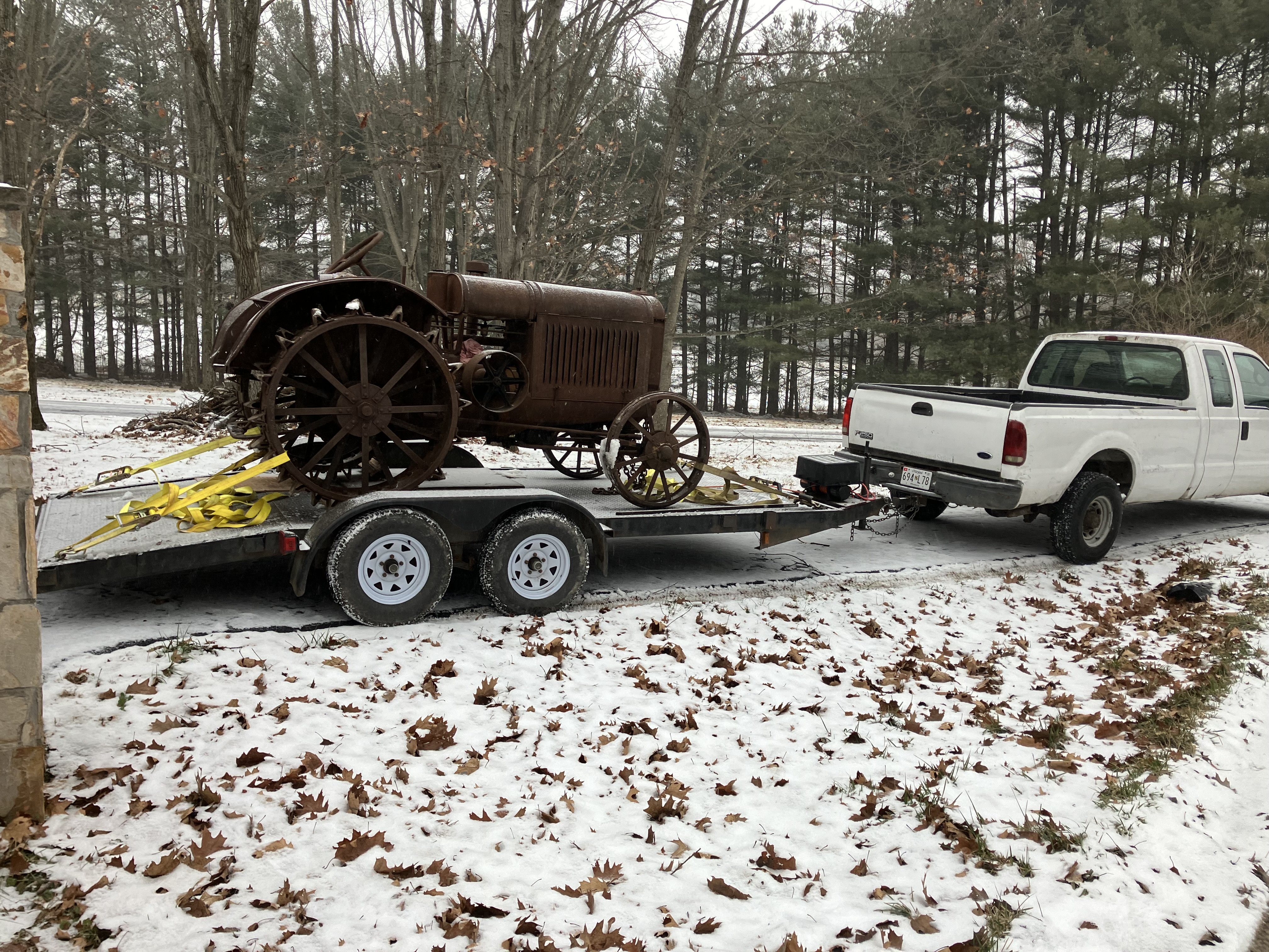

and to answer your question i say the jackall is one of the best all around jacks. and with a load on a trailer you can jack on the frame and take most of the weight off then put a hyd. jack under the axle. always carry these two in my truck pulling a trailer. plus a couple short planks . been carrying a jackall all my life in the back of my trucks. i always travel prepared, including booster cables and tools.
I may go that way--jackall and hydraulic bottle jack even though it means carrying two jacks instead of the one I had in mind. They are both small enough I can stow them away without using up too much space.
