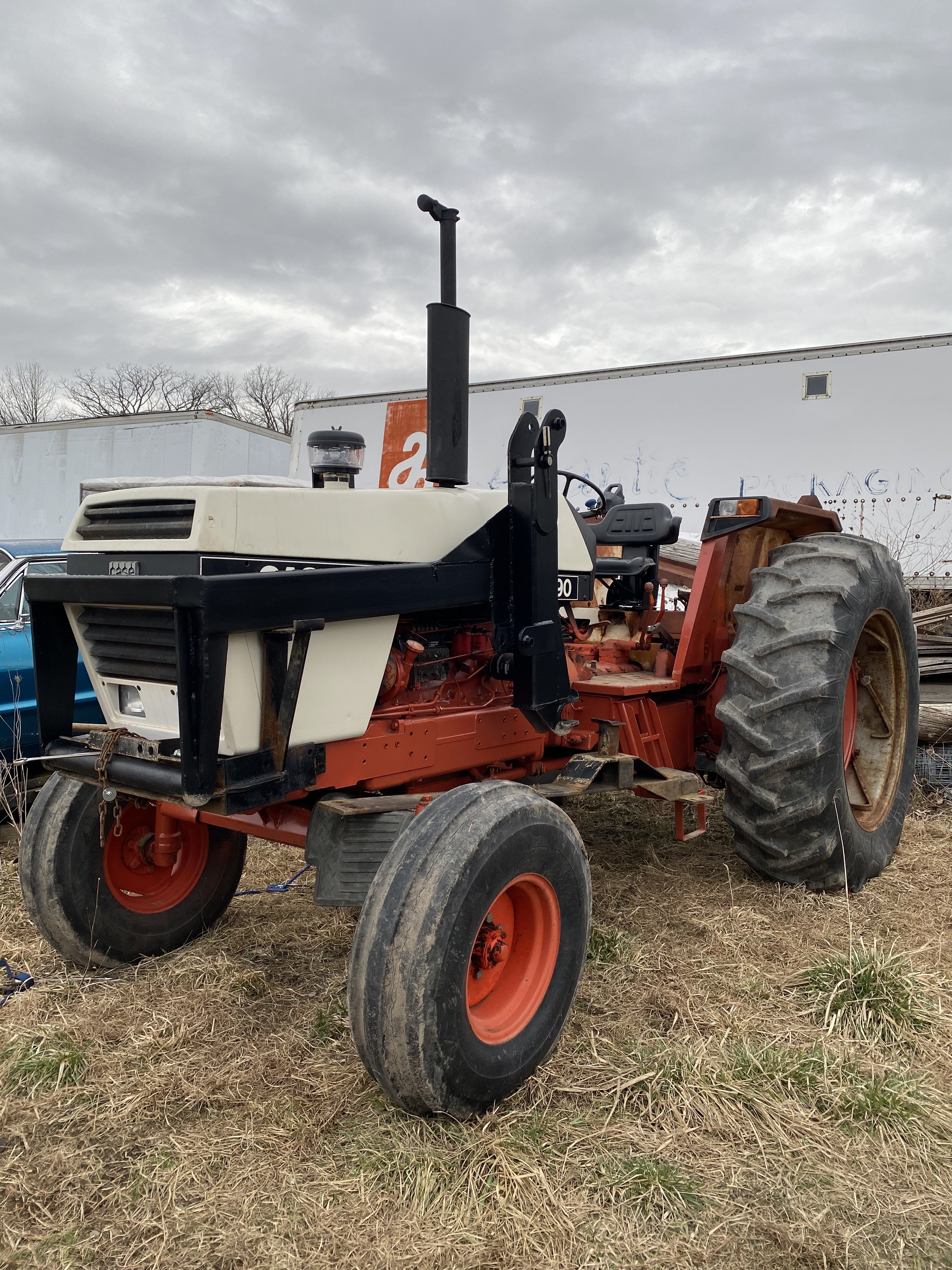

Hi there, I installed a loader on a 1690 that I bought and fabricate to fit. It’s on the tractor but I’m having trouble tapping into the hydraulics without going into the remotes, this loader has a valve and joystick controls. Any info would be appreciated. Mike

Does your tractor have dual remotes? Most guys end up using one remote to supply the loader valve.
It does have two remotes but I’d rather not use them if I can. Thanks

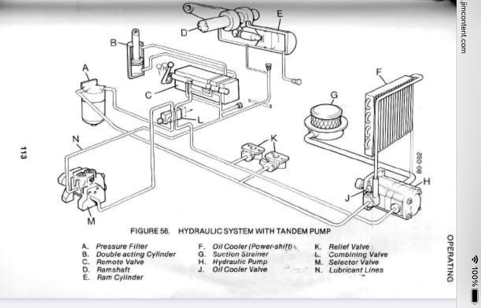

Can you send a picture of the hydraulic remote valve and/or pump on the tractor? Not sure how it mounts on that model. You may be able to tap into the line feeding the valve from the pump. Per tractordata, your tractor has open center hydraulics.
I found this drawing on line but will take pictures of pump. Thanks
