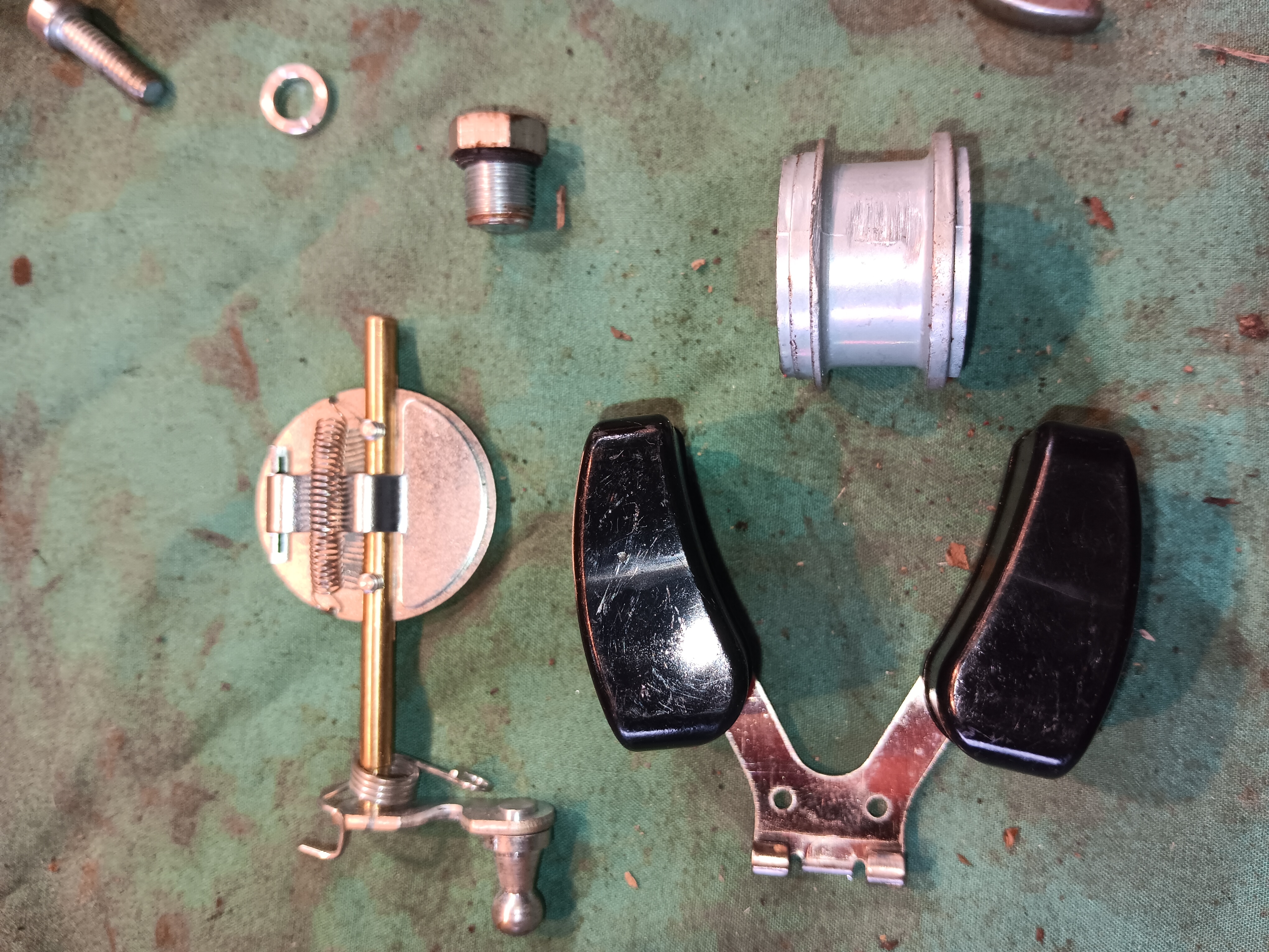

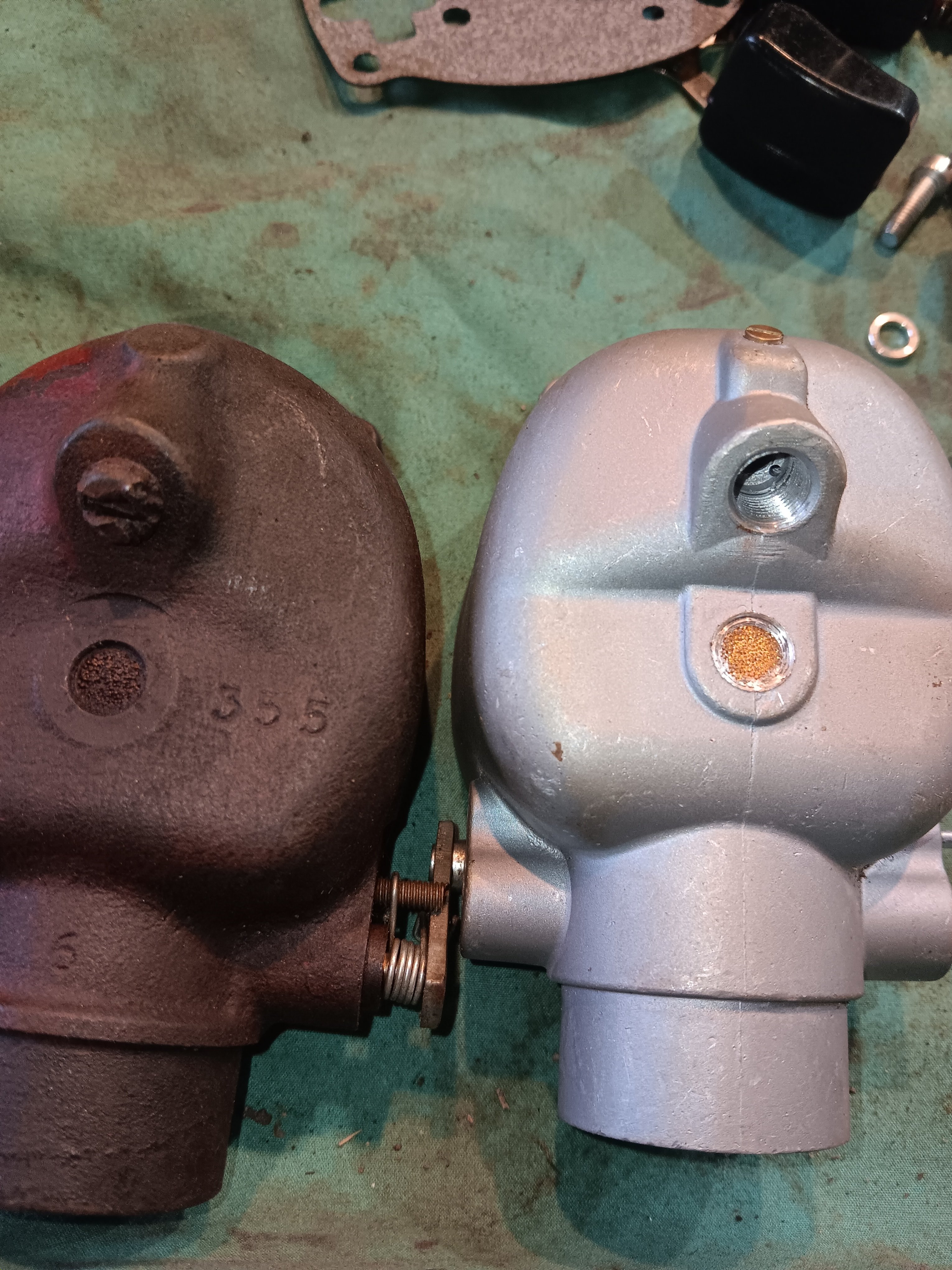

I bought a cheap $38 carb a few years ago . I took it apart today . The screws and such were not metric and consistent with what would come is a cheap rebuild kit . None of the screws had thread locker applied and removed easily .
The top half bolted to an old MS bottom and the bottom half to an Old MS top . The shafts , choke plate , screws . needle , seat interchanged .
The sintered drain appears the same size . I did not remove it since it is swedged in place and would probably destroy the base trying to remove it intact . The hole in the new carb drain is about .035 where the MS carb is about .200
I did not remove the jets .
The float is some kind of plastic . May be good if it is fuel / ethanol resistant . It is not going to collapse .
The Venturi is very sloppy cast zinc ? The air flowing through it looks ok , but the air seal for the air flow around it looks likely to leak vacuum .
The biggest problem is there are NO seals on the shafts . Just a snug fit to the base metal .
The drain plug has the right thread count but is not tapered . A pipe plug may work . I would want to tap it first . The fuel inlet was also in issue but could be used with a little help .

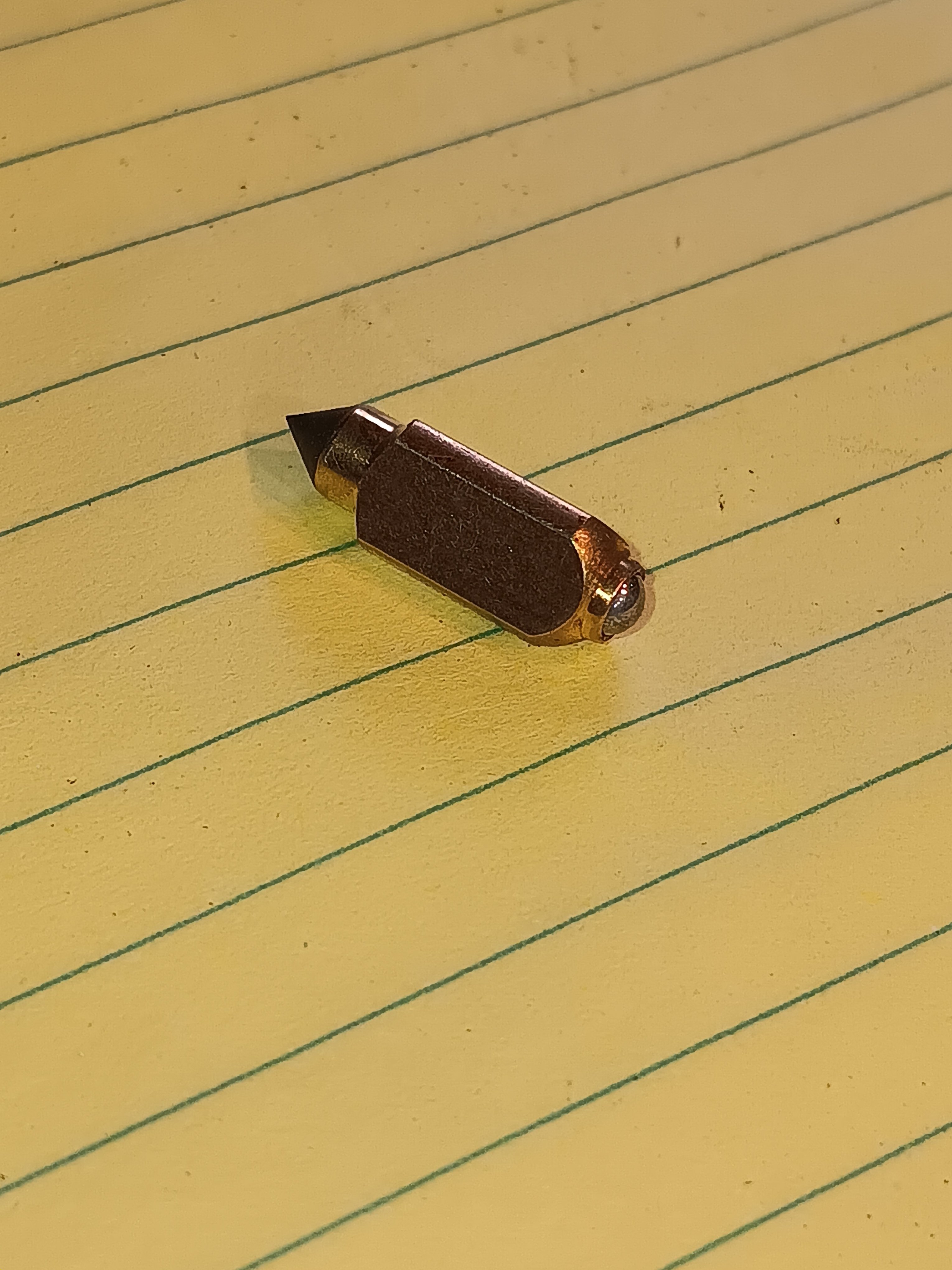

The needle has a rubber ? tip and a spring loaded ball on the float end .
The ports to let fuel enter the main jet look very restrictive compared to the MS carbs . They are one drilled hole on each side , 2 total .
I would say they are good parts donors . They would probably be OK for a few years IF you overhauled them first , but nobody wants to buy a new carb just to rebuild it first .

They are still making those MS carbs.
I can't tell you where the machining is done or where the innards come from but the bowls and covers are cast in a small, hi tech foundry right behind my house.

FWIW & FYI: Needle & Float Valve uses a fiber gasket too. Be sure old one is free when installing the new one. NO PERMATEX or THREADLOCKING USED! My tools include an old Craftsman Chisel that has a wide blade. Required to install the seat with to prevent damage to the slot on the brass seat. I also advise to use a 3/8'- 6-PT DEEP WELL SOCKET and screwdriver handle and a 1/4" DRIVE Socket Wrench for installing the Main Needle Jet Stem with.

I need to edit my post . The 4 screws that hold the top half are not 1/4 - 20 . They are very close and physically worked but not correct . Same with the plug and fuel inlet . Very close but sloppy . I will probably never see if I can tap it with an 1/8 npt . I have too many other things on my list .

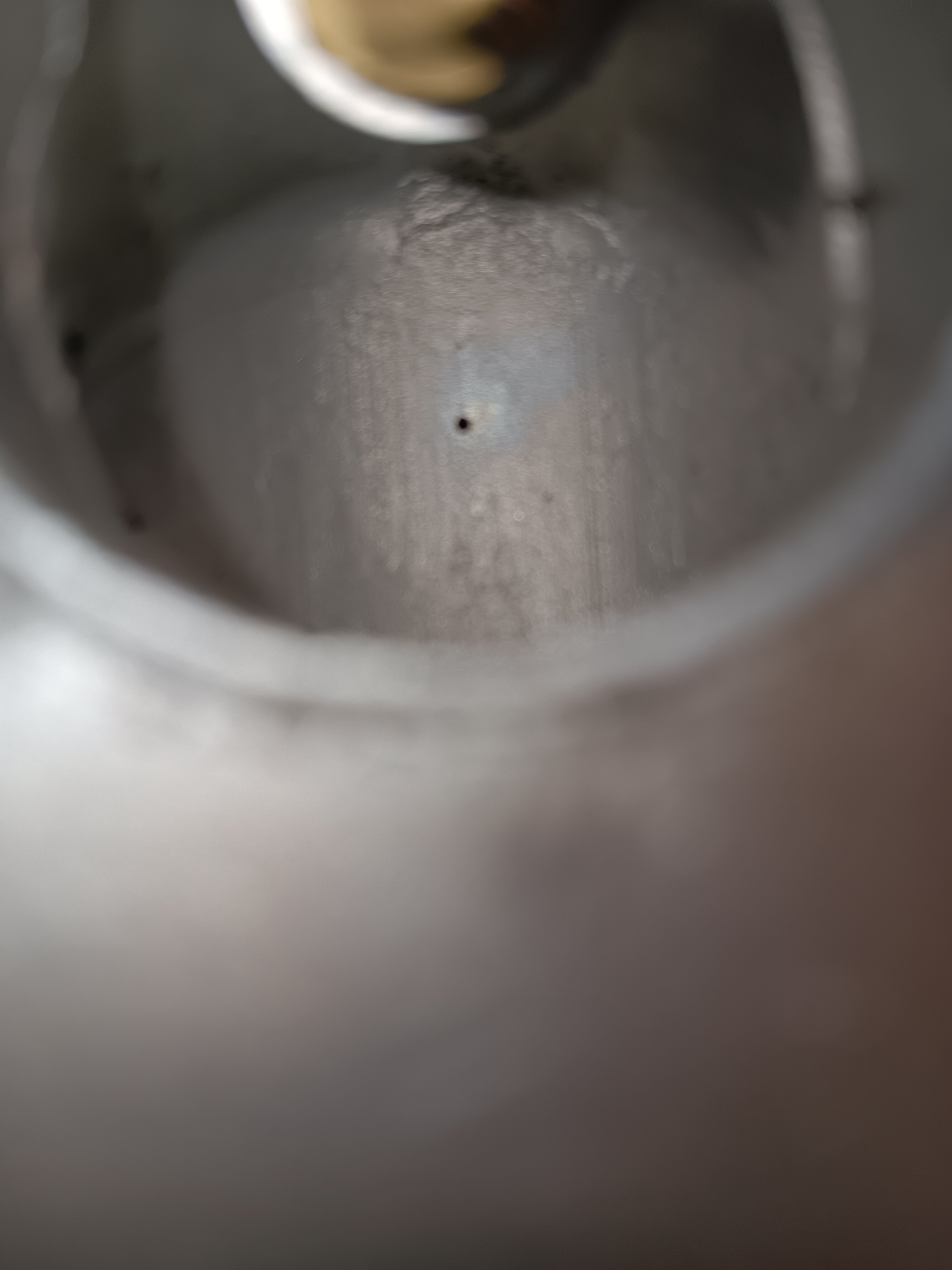

Is there any defective part in the chinese carb that can account for the inability to go uphill forward?
It is a common problem with them. I have one tat will not clime a 5° slope forward, and has a very hard time accelerating in 3rd, especially with the high range (Sherman). Reverse is no problem, but having to back up on a hill is rather inconvenient.
Is this shown in the picture labelled orf? If so, where is that?
There was an amazon review that said the uphill problem was fixed by drilling out a hole or holes, but I couldn't make enough sense out of that description to figure out which holes the review was describing.
Hobo, you said that yours idled and did not run well off throttle. What I have doesn't idle very well, but does have power on a level or downhill surface. It just can't go uphill. I have a 5° slope ending in about 20 feet that is a little steeper. With a running start it can barely make the first part in 2nd with enough speed (~3-4 mph) to stumble the last 20 feet. Sometimes the choke helps.
First thing I would look at on the "hill" problem would be float level.
